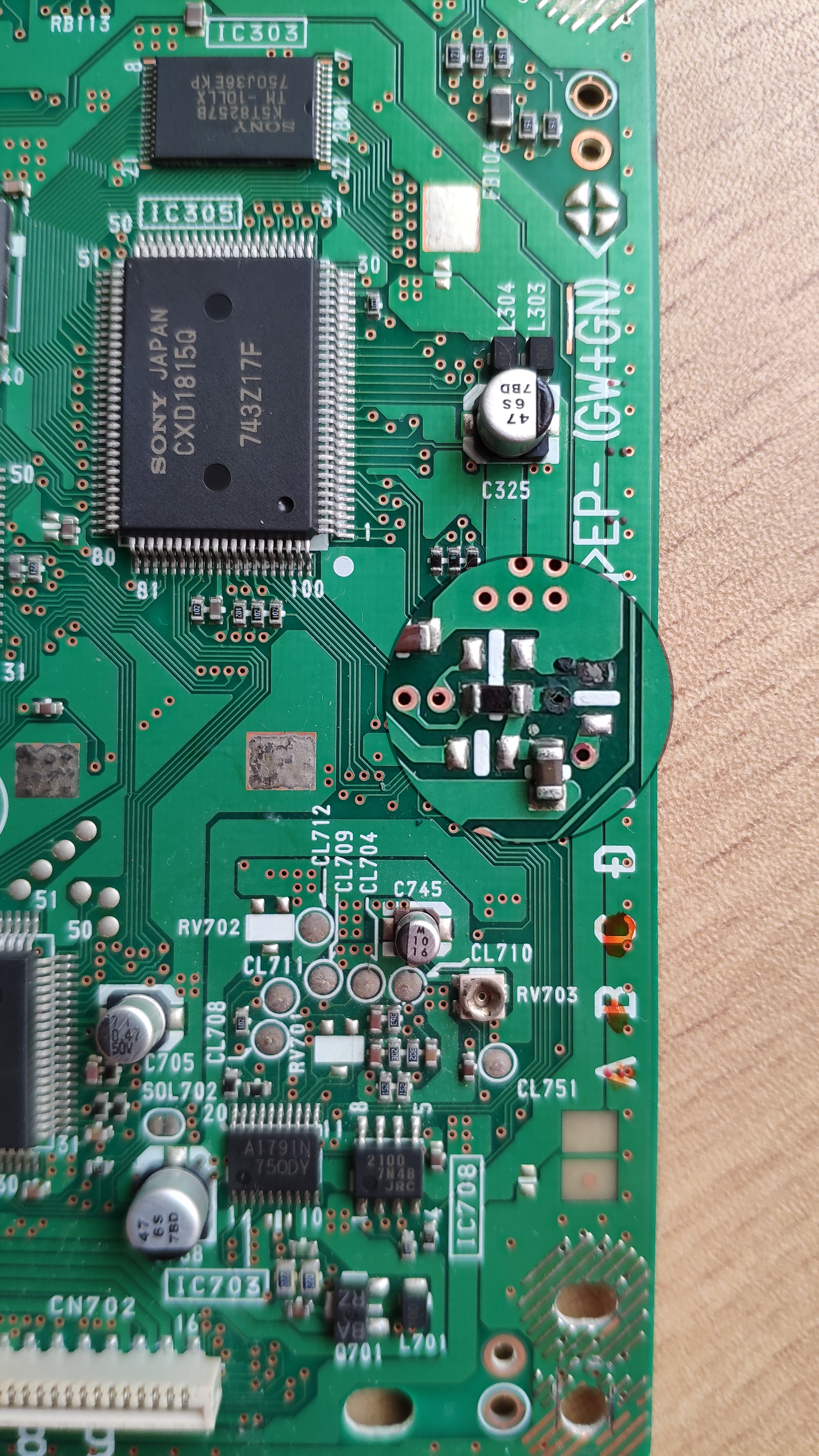

    Just a small update, the ps1 is a PAL scph-5502 PU-18 pcb.
    I was looking carefully and I found a little bit of oxidation in a smal point.. a cleaned up and I took a pic..
    is there a component missing (that is the left upper side of the pcb)?

  7. Oakleaf
    Oakleaf Spirited Member
    Nov 9, 2016
    141
    26
    dont know about the components, id hav to check. But that via needs patching. A small wire maybe?
