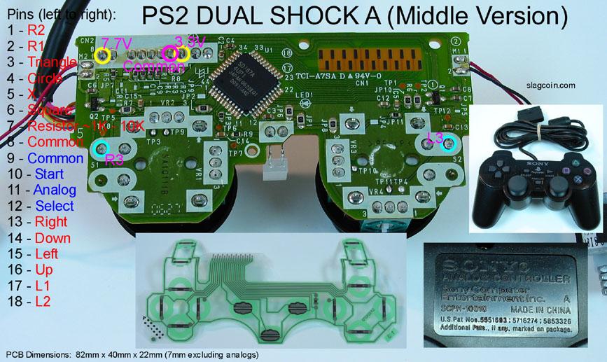

    Have a Sony Dualshock 2 Playstation 2 controller.
    It doesn't want to power on, meaning that not even the Analog LED turns on when plugged in.
    It is a middle version Model A.
    Here is a sample picture of what I'm dealing with.
    http://www.slagcoin.com/joystick/pcb_diagrams/ps2_diagr...
    I already reflowed all the solderjoints.
    Nothing has happened.
    Already tried aligning the circuit sheet and taping it down with electrical tape.
    Didn't try cleaning the board and circuit sheet, though - (The 18 black marks that the circuit sheet lies on top of)
    Should I splice a little bit down the cord to check?
    Or what could be causing this malfunction?
    Don't tell me to junk it. Every controller deserves a second chance.

    Have you checked for continuity from the plug to the controller? Often a wire breaks inside the cable due to the winding/unwinding.

    I have a few ps-2 controller's I took the knob's off for someone a while back. If you need extra part's I would be happy to send you 1 or 2 of them. Are you in the USA? Got to go see if they are Playstation 2 Controller Middle Version A. But it very well could be the cord like Sonny_Jim said.
