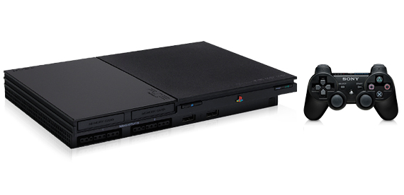

The One and only, Classic I got a chance to get this unit modded with Super 7 E17 for a cheap price, DateCode shows as 2B (I assume it was the last few batches done up in 2012). I was wondering on the reliability for this slim compared to 7000X,7500X,7700X and 7900X series. Does it have overheating issues and laser issues like the earlier slim models? (Where romeo mod is needed to prevent the laser from getting spoiled for those who are playing with copies) I understand that this series with datecode 8C/8D or above wont be able to boot FCMB memory card, however its not really important to me, as the USB compatibility using USB 1.1 ports is low compared to Phat PS2 using Network adapter and IDE hdd. (I have already got a V7 Phat SCPH-39001) Thus, I just want your thoughts and opinion on is this the best built of the PS2 Slim available?(In terms of Laser (Uses KHM-430C, Cooling and durability) ----------------------------------------------------------------------------------------------------------------------------------------------------------------------- Dimensions Approximately 230 mm (W) × 28 mm (H) × 152 mm (D) Weight Approximately 720 grams Power Requirements 120/220 V AC, 60/50 Hz Electrical current consumption (power consumption) Approximately 35W Compatible Format PlayStation format CD-ROM PlayStation®2 system format CD-ROM PlayStation®2 system format DVD-ROM Audio CD DVD-RW (VR mode) DVD-Video** **The term "DVD-Video" is used to refer to DVD-R, DVD-RW (Video mode), DVD+R and DVD+RW discs. Interfaces 2 Controller Ports 2 MEMORY CARD slots 2 USB connectors 1 NETWORK connector (100BASE-TX/10BASE-T) 1 LINE connector (modem : RJ-11C) 1 DC IN 8.5V connector 1 AV MULTI OUT connector 1 DIGITAL OUT (OPTICAL ) connector 1 Infrared I/R Receiver
I cannot comment on the reliability of this particular model's laser (Somebody else has to comment on it here)... but I can say that slimlines have the best drives (Excluding the SCPH-70000 series), in comparison to the fat PS2s. AFAIK, the Romeo mod is for the SCPH-50000 series, and not the slimlines. USB game compatibility is actually not that bad. Only a handful of games won't run, but these games have either some bug or they've broken the Sony TRC without Sony discovering that (Or they were lax regarding the rule that games shouldn't perform timing based on the CD/DVD drive's transfer rate). If OPL cannot allow you to run some games, try PS2ESDL instead (It has a different game compatibility list), and is tuned for USB device support. My own slimline is a SCPH-77006. This one is the console that I've been using to develop software since 2009. Which means that it's been heavily used because of how long my coding sessions are (Even the laser, because I used Swapmagic before I learned what FMCB was), but it still works fine. Today, it does heat up, but I think that my SCPH-10000 consoles are scarrier. There was a discussion on PSX-scene regarding the "best" PlayStation 2 model. I remember that they were saying that the v4 was great because it had the least problems, the v7/v8 was great for modding, and the SCPH-77000 series was the best (or was it one of the best?) slimline. I don't remember whether the SCPH-79000 was out then.
