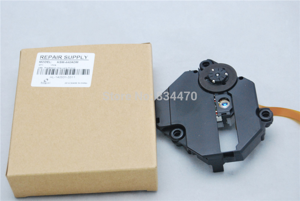

    you could adjust the pots on the pickup but this is just a temporary fix..
    a "new" optical pickup, which most of the time is a refurbished one (new diode and cleaned) is probably going to last longer than one pulled from a system.
    Two completely different things, if you are talking about the blinking light win, it's just off the shelf parts.. Two female card edge connectors that match the pitch and tolerance of the original.. oh and a 50cent PCB
    Here is one : http://www.aliexpress.com/item/KSM-..._78_77_80,searchweb201644_5,searchweb201560_7
  3. supersega
    Jul 25, 2014
    491
    145
    No joke, this was the EXACT laser I bought, straight from Honglei on Alibaba. If the OP purchases this, I hope he reads this...
    -One of the lasers I bought had the "Focus" pot turned up 100%, tightened down, like a screw.
    -All lasers needed a little potentiometer tweaking.
    -They DO NOT like SCPH-1001 or early consoles with on-board power adjustments.
    -It comes with posts that need to be cut off if you want to use it with a SCPH-1001 or early Playstation.
    -One WEIRD problem is, I modified one of these to fit in a SCPH-1001. It will not spin at all. However, if I put a completely different laser into it, then it works fine. BUT, if I put the old one that I modified into any other console, it works great.
    Just tread carefully. It should most likely be fine!

    I also had issues with my main PS1 ( SCPH-5552 - same as yours ). I originally replaced the whole laser assembly with an original ''refurb'', but it was bad from the get go.
    I then decided on taking a punt at the Chinese clones. I purchased a few of them at a cheap price so I could just throw away and replace when one started playing up. This was a few years ago now and I'm still on the first one. No reading problems as of yet.
    Considering how cheap and easily replaceable they are, I think it's a good alternative to paying more money for an original that is probably not too far from crapping out itself.
    lol, I know I'm going to get some stick for this, but I really think it might be worth looking in to. Yes, they are crap build compared to the original, but that doesn't mean they don't all work. Your millage might vary though depending on CD-R brands. I have stuck to using the same JVC branded Taiyo Yuden discs that I can get in the UK for relatively cheap.
    Good luck!
