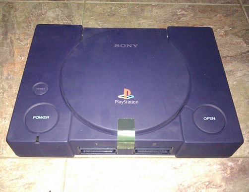

    I just got the Midnight Blue PlayStation I ordered in the mail today. It's the Japanese version; its model number is SCPH-7000W. This is interesting, because the online pictures I see of the American and European midnight blue systems' labels shows SCPH-7001 and SCPH-7002, without the W, respectively.
    I'd take some pictures, but my scanner isn't hooked up yet for a label close-up.
    Its CD-ROM firmware appears to act like the Yaroze. It boots both American and Japanese games, but not *ahem* master disks. I don't have a European PS1 game to try with it. Unlike normal retail models, the boot screen does not show the copy protection string (SCEI tm/SCEA tm/SCEE tm). That's like my two debugging stations.
    I don't have the Yaroze boot disk to see whether it accepts the "SCEW" copy protection string.
    I have a DTL-H1002 and a DTL-H1101. I just need to get an SCPH-5903, a DTL-H300x, and a DTL-H120x to complete the set. Unless you count that weird Men in Black variant Wikipedia mentions. =)

    The console:
    The box:

    Well, it was a pain in the ass to get it, but I have it now. I used my old DexDrive with a crappy USB-to-serial adaptor, and got the output image. Its MD5 and SHA-1 don't show up in Google; this probably just means it's a bit corrupted somehow. Wouldn't surprise me, due to this cable apparently being a Chinese knock-off.
    Anyway, these are its identifying strings:
    CEX-3000/1001/1002 by K.S.
    System ROM Version 4.1 11/14/97 A
    I was right - it's an American BIOS.
    The seller either didn't switch out the board, or switched it out with a Yaroze. The former is far more plausible, so this is an "NTSC J"-labeled system with an American BIOS. It has the Japanese-style power cord (symmetric), though.
    MD5: B84BE139DB3EE6CBD075630AA20A6553
    SHA-1: 1B0DBDB23DA9DC0776AAC58D0755DC80FEA20975
    SHA-256: B3AA63CF30C81E0A40641740F4A43E25FDA0B21B792FA9AAEF60CE1675761479
