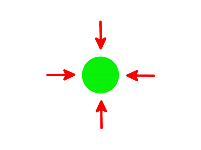

    hi britain , below is a pic i made of the laser eye..............
    theres sort of a cover around the laser eye you have to take it off to do this , simply once the cover is off you press with a small screwdriver where the arrows are
    for mine i went East then West then East West then North South then North South , when doing this you want to be careful and not scratch the lens
    once this process is done reassemble and test...................
