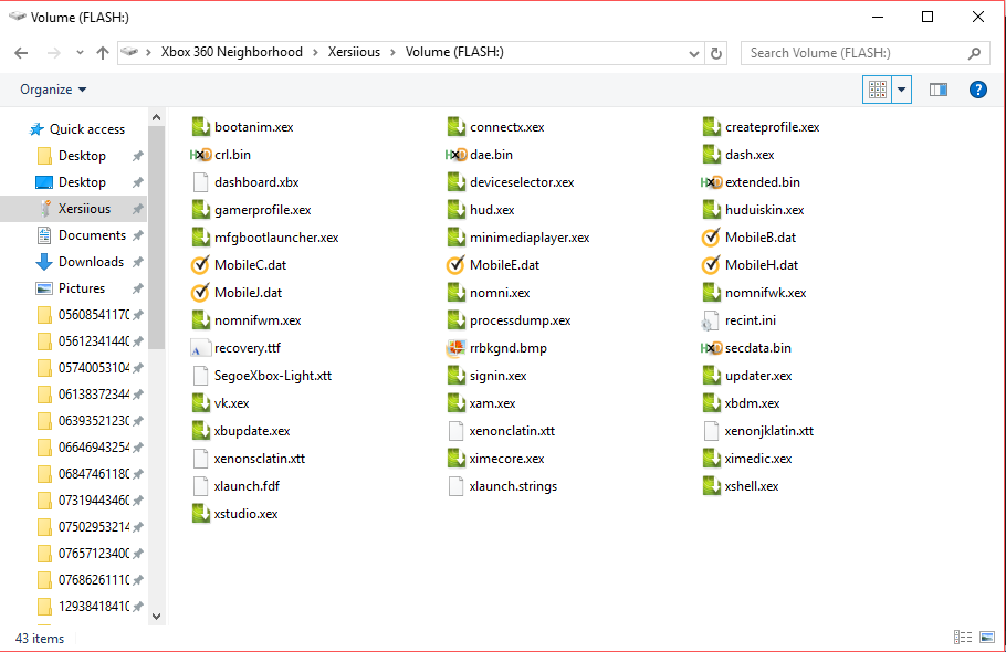

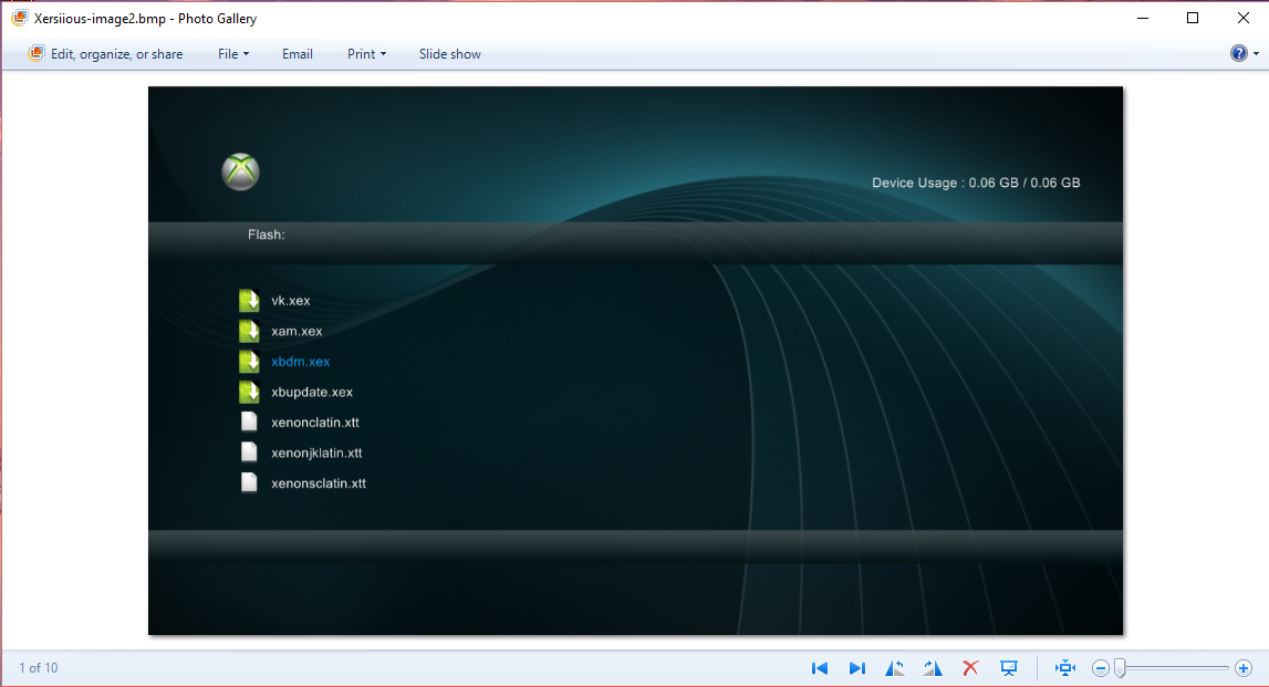

  14. iKeo
    iKeo Rising Member Marketplace Suspension (Rules violation)
    Jan 24, 2016
    52
    Ive been reading the replys and was just curious because i have a Zephyr Test Kit with FLASH: access and has xbdm on flash, just curious?
  15. Lehvak
    Lehvak Bürgermeister
    Sep 28, 2014
    117
    111
    test kits have xbdm.xex (both phat and slim), but phat test kits are missing a lot more files from the flash compared to a phat dev kit.
  16. iKeo
    Jan 24, 2016
    52
    Ahh I see i would like to see a comparison cause im curious
    heres my flash of a test kit if someone whats to compare in the future
