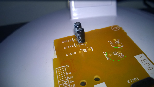

    Hi all,
    I'm a long time lurker and this is my 1st time posting, so hello, hello my fellow obscure video game enthusiasts!
    I recently bought a couple of 'junk' Sega game gear's from a dutch Craigslist and started to replace the caps.
    I didn't have all the right ones so I went over to my municipality 'junkyard' and salvaged a VCR and a DVD/HDD recorder for parts.
    But now I'm in doubt about these caps and their polarity so maybe you can help me out? :)

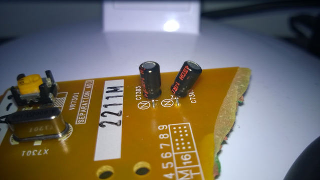

    Is the red side negative? I think it shows a minus as well but I'm not sure.
    On the PCB there's an N printed on the 'red' side so I'm assuming this is N for negative.
    The other Caps all have - on their sides - and + on printed on the PCB hence my confusion.
    Thanks for reading.

    White stripe is negative on those black ones (standard)
    the red ones idk because I don't think I've ever seen caps like that. I'd assembly the writing along the side doubles as the negative stipe..

    Yup, still a negative stripe.
    Don't be a cheapskate, though - buy new ones. You don't want to replace old caps with old caps. Those 10uF 16V caps are all of 15 pence (0.20 Euros) each. In fact, they're about 8 cents in the US.

    Aha! Thanks for the clarification.
    There is a special type of electrolytic capacitors for AC use, which is designed to withstand reverse polarisation. This type is called the non-polarized or NP type.
    The N stands for non polarized and not Negative, duh.

    Ahh, I was looking at that as a Z! lol. Of course it is.
    I've posted a list of distributors as a sticky... uhh, somewhere! Any of the big boys should sort you out with next day shipping. Much easier than having to crack it open again when your replacements fail. A good rule is that capacitors have usually had it after about 7 years. When was the last VCR made? I'm thinking these are ooold capacitors.

    The white stripe is neg like the others but the other caps are N non polarized on the cap also should have the N in a circle . Most old audio circuit and speakers will use them.
    Like the others say new and quality is the way to go.
