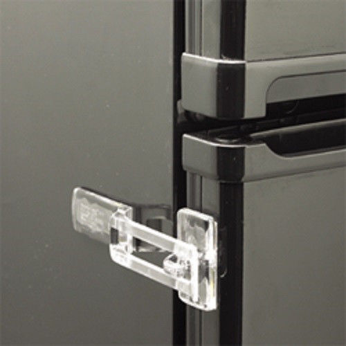

  9. Eviltaco64
    Eviltaco64 or your money back
    Jul 16, 2008
    1,027
    136
    When all else fails, you can get one of these:
