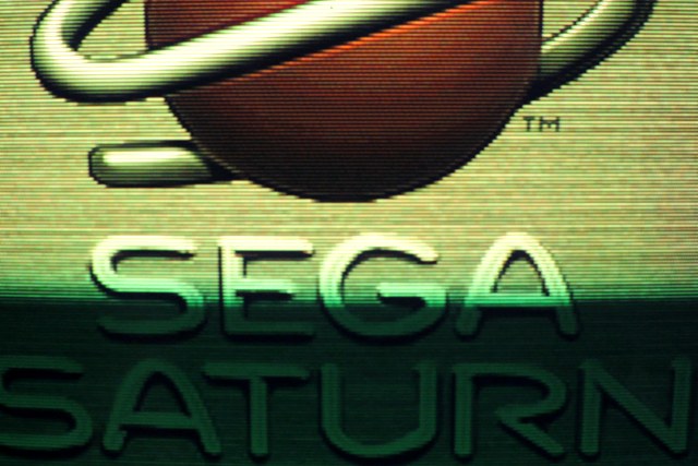

    Hi. I recently picked up Trinitron monitor and it works very well with older consoles except Sega Saturn. On Saturn picture goes very yellowish. All other consoles I tried (PS1, PS2, Mega Drive) there was no problem. However my Saturn works without problem on LED TV's with same RGB SCART cable but for some reason on Trinitron image is yellow.
    Also tried both PAL Model 1 Saturn and NTSC-J HST-0001 but same thing: yellow picture. Monitor is PVM 20M2E.
    If anyone have any idea what could cause the problem, please let me know. Also new member to forum so hello ˆ_ˆ

    Hmm.. but with same cable and LED TV colors are normal?
    Confusing but I guess I still need a new cable.

    Japanese Saturns have different pinouts - you can't use the same RGB lead as PAL.
