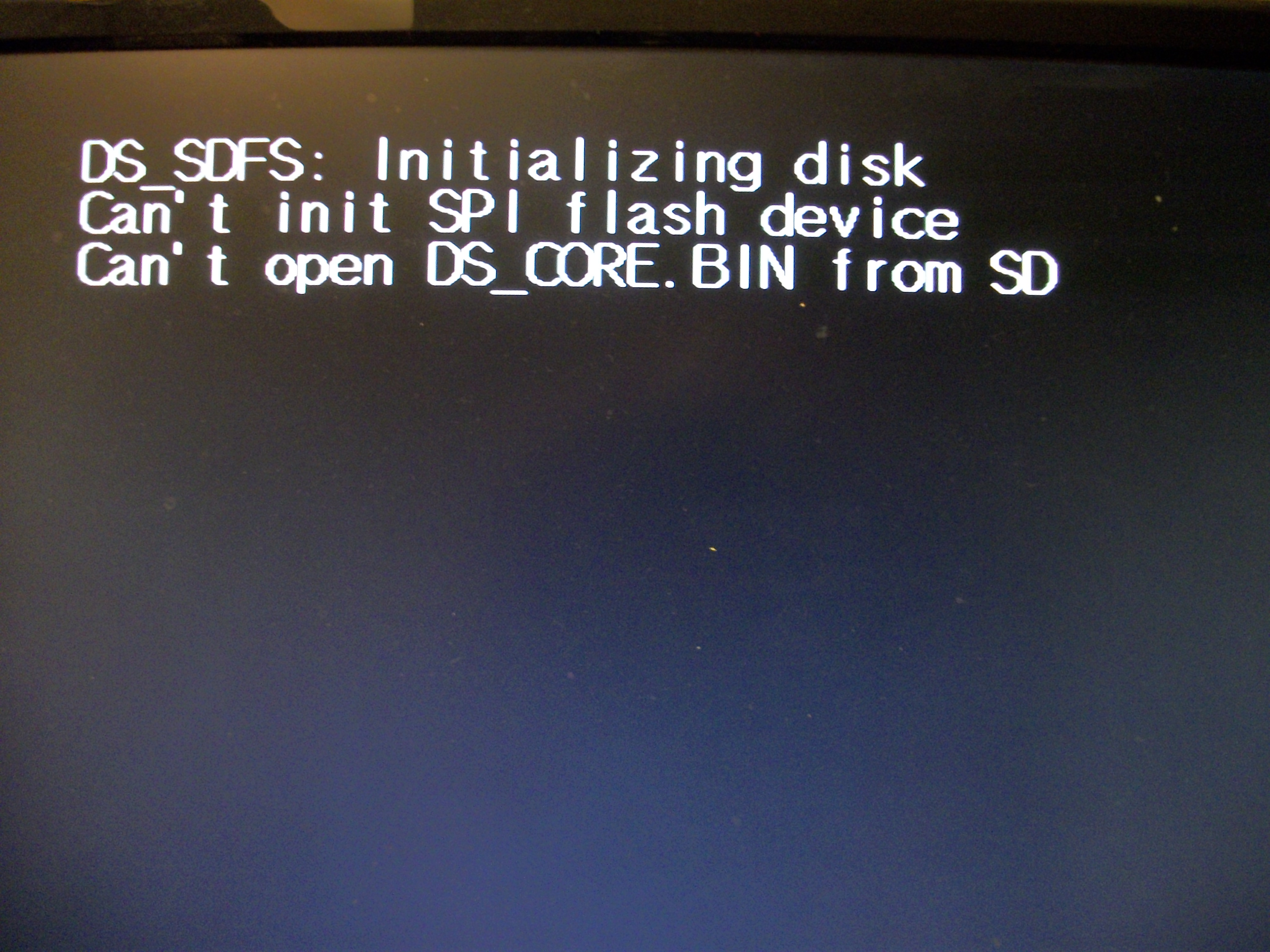

    I need some info please I just installed a bios replacement in my DC and completely removes the stock one instead of doing the dual bios I then erased and installed Dreamshell bios and now I 'm stuck on the screen shot below I have not purchased an SD card reader yet is there anyway to force the system to bypass this screen it just keeps loading this screen over and over again or do I have to purchase an sd card and load stuff up on it to get any further thanks for any help

    You need an sd card even though you installed it as a bios there is a DS folder that must be on your sd at all times as it has your ds_core.bin file the app is looming for. You could in the mean time from the cd only version that doesnt need a sd card as it is embedded on the disc if you just want to try it out but it is god awful slow.
