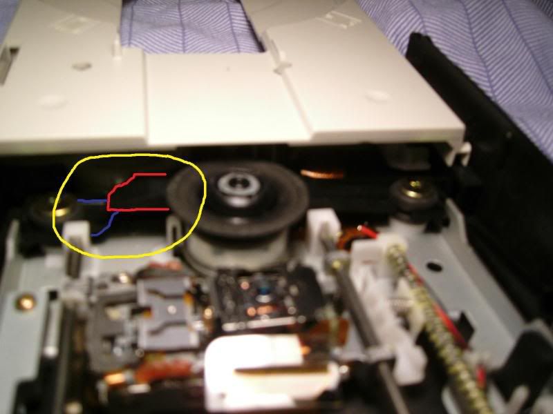

    Right, disassembled the CD drive and its fucked. Part of the plastic that lifts up the lens and spindel motor has broken in half. Not sure what caused it to break in half, looks like a fairly sturdy piece of plastic.
    Blue and red highlights are each of the broken pieces of plastic.
    So it looks like I'm gonna have to replace it. I have a spare 'Lite-on IT Corp Model LTN-486S' 20-48x speed IDE CD-ROM drive here, will that be ok to use? I put it in and connected it up but the PC-98 checks the memory and then goes to a blank screen.
