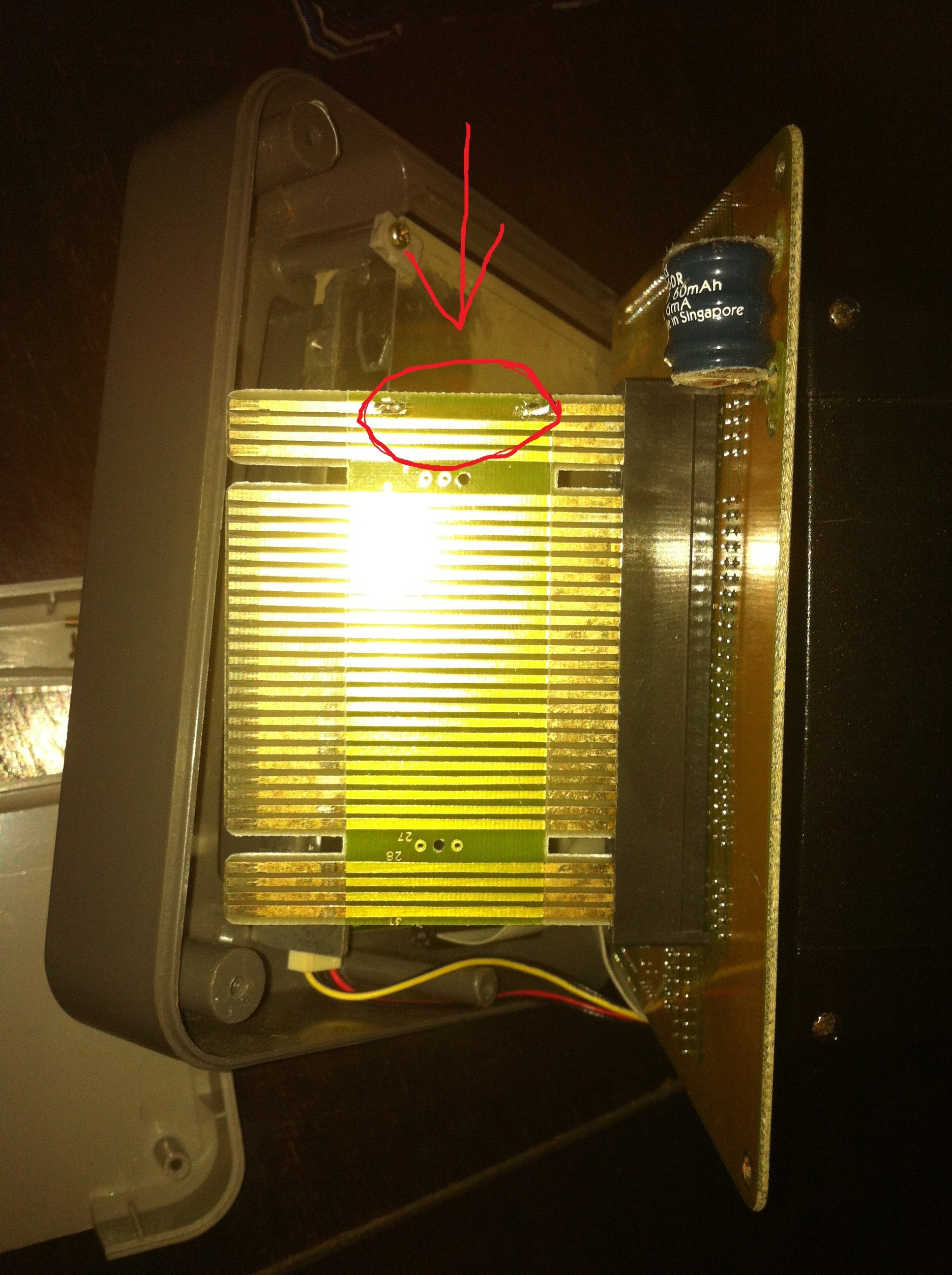

    I was at a Garagesale today and bought a Super Wild Card for my SNES!!
    It starts and i can get into the menu but as soon as I want to start a game from disk, the disk loading progress is shown, but after that I get a black screen.
    Since I dissasemble a lot, but never has a piece of these!!! I was stuck at one point!! There is something missing between the Super Wild Card and the SNES on the Adaptor!! I was wondering if anybody could help me!!!
    Here is a picture of the part, i mean!
    on far left side!! Would be very thankful for help

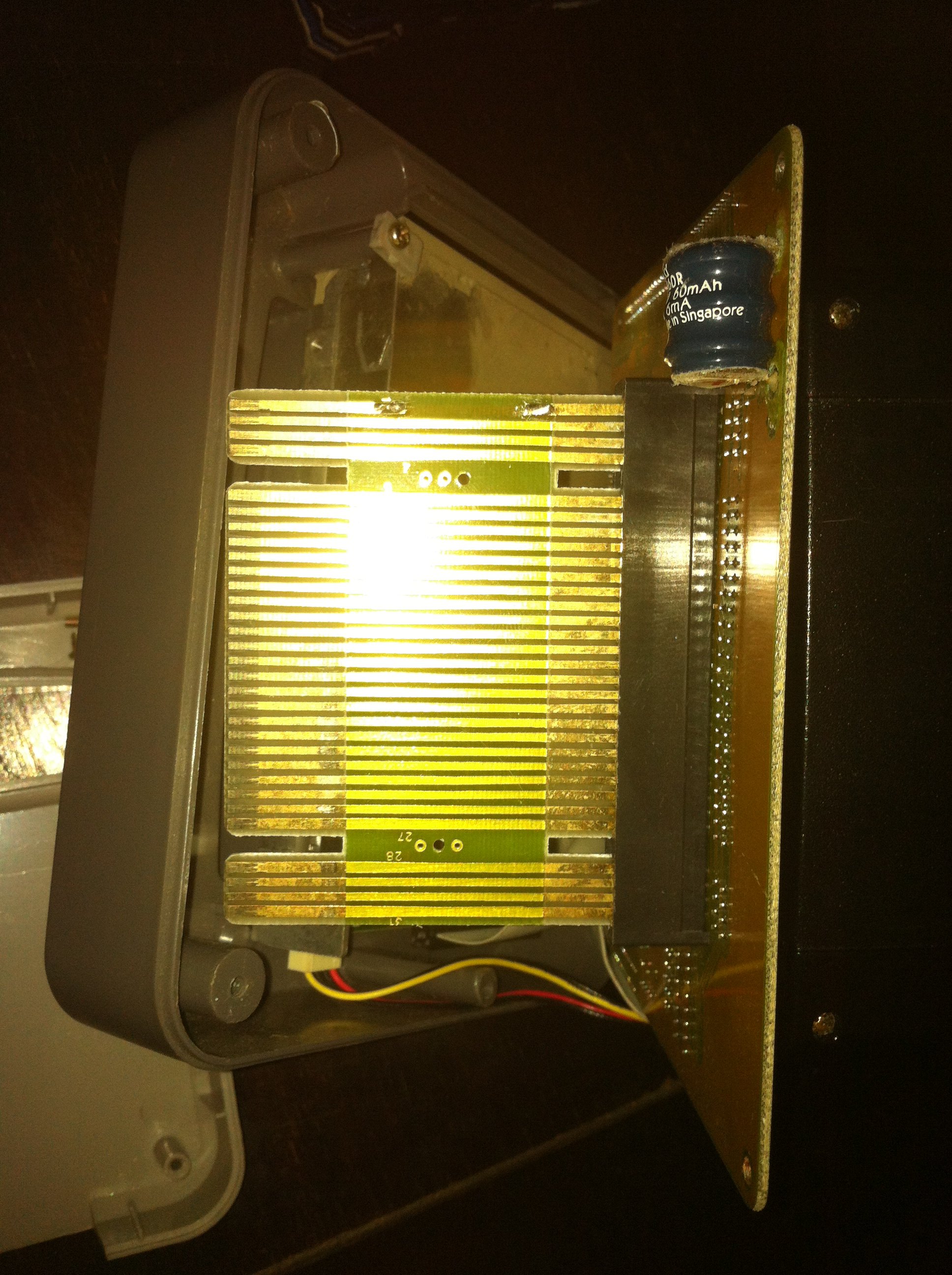

    This time with circle around it!!

    Get rid of that battery. It leaked. :\
    And that trace is intentionally missing a trace. Some ignorant peasant decided to solder a wire on it then changed mind.
    You can simply make the numbers on the adaptor board match that printed on the Wild Card board. You can also solder a piece of wire there and not care about the way it's inserted.
    But for the device's sake, get rid of that leaked battery.

    Okay I got rid of the battery and just soldered a cable as a bridge!!ar
    WORKS, well kind of!! Starts the games from disk now!! BUT... ;-)
    Let´s say i want to play Star Fox through the Wild Card, it won´t work!!! other games like Zelda will work and i can copy them to disk!!
    Star Fox has the outer pins on the cartridge right where i made the bridge!!
    Any Idea if there needs to be a resistor or something like that???
