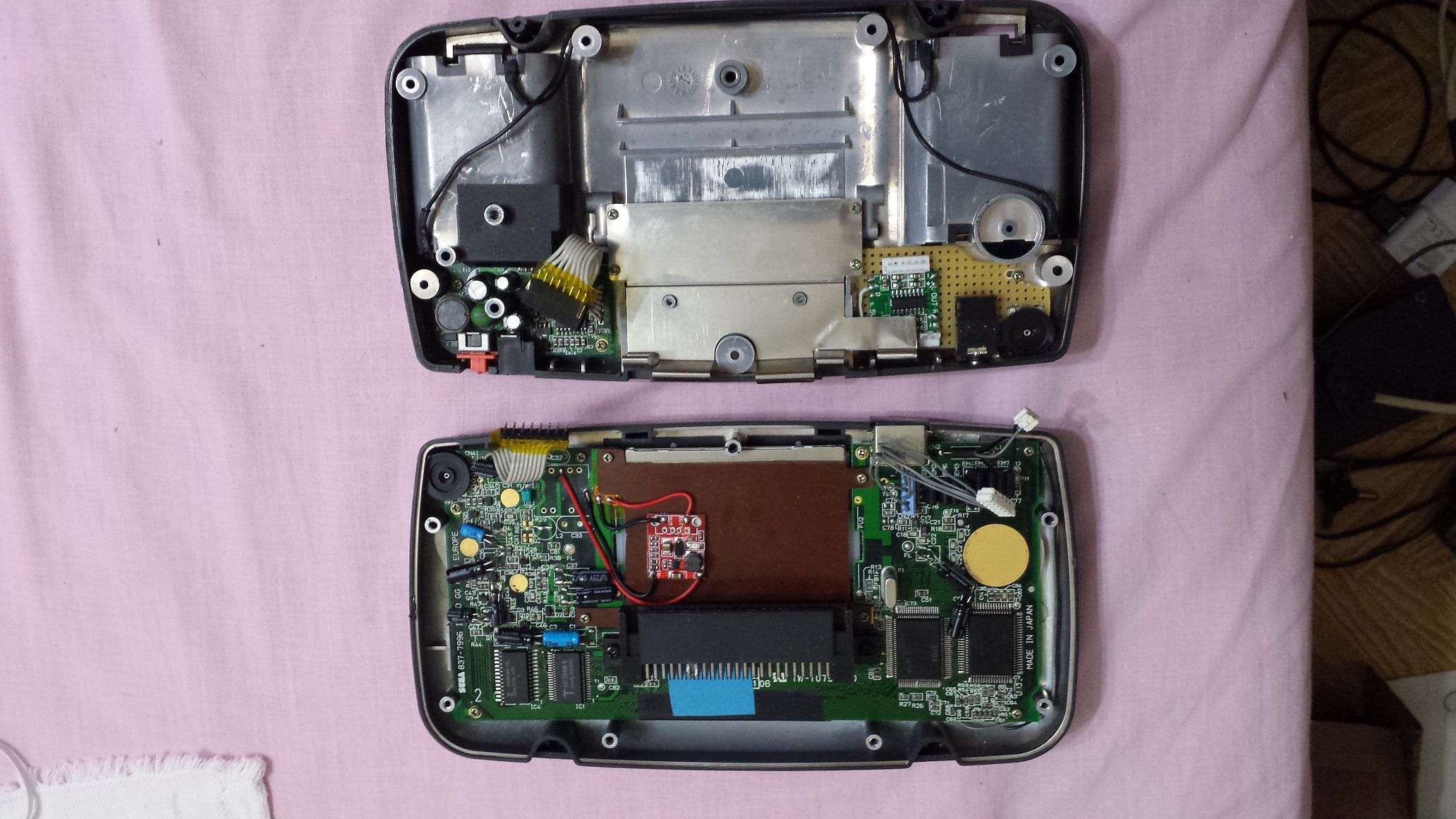

    I tapped into the output from the mainboard and the sound is ok... the problem is from the audio board. I will post a picture of the setup i have ... to show you:D
    Update: replaced the caps with the metalic kind... that the soundboard was fitted with originally... the sound is better but there is still some static and the volume of the sound is normal (not loud) with the pc on full blast...(that means the output from the audio board of the game gear is lower than the output of the pc)

    Ok so I gave the console a few days to rest I had a few exams and other stuff to do ... so I couldn't stress it out and play it without sound:)). So after trying to test it out ... it didn't start up... but after 5 minutes or so of standing on her own and ON it started all of a sudden to play the game. Cap problem?
    Ps: got home and tested it out a bit seems it's the display caps tho I had new ones soldered... I will change them again what to do:(. It seems that the game plays and after a while the image starts appearing and after a minute or so bamm full image :eek:

    15
    Still having trouble starting up ... but i've manage to make a sound board using a PAM8403 and some help from ebay.... LCD backlight compliments of Nintendo DS Lite with a voltage step up to 12V and a PAM 8403 custom perfboard:))) Hope you like it... and looking forward to hearing from you guys on maybe some help to the capacitor problem.
