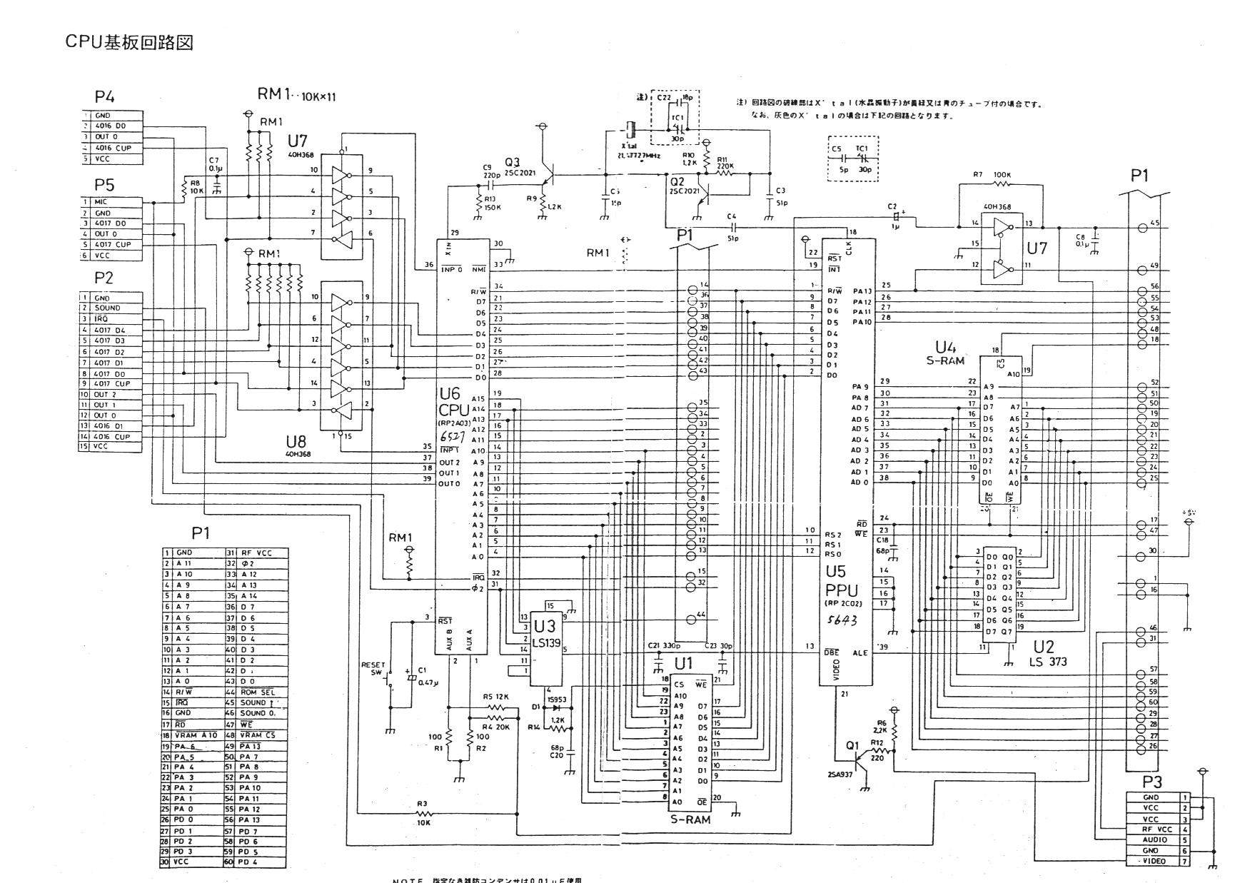

    The AV Famicom has an expansion slot. You can still use the Hori 4 player adaptor.
  2. Calpis
    Calpis Champion of the Forum
    5,906
    You can use the Hori adapter but not with NES games. If he gives his NES a Famicom style expansion slot, he can play both. Otherwise he'd have to mod the AV FC's controller ports to give them some expansion bits present on the NES to use a satellite/4score. Besides, Famicom peripherals are not cheap, especially the gun; the NES equivalents cost like 5-10x less.

    Yes that what I do, I bought an New Famicom and routed wire from the FC expansion slot (P2 D3 & D4) to the missing signal pin on the nes port #2.
    Port #1 D3 and D4 are not present on famicom exp. port, to get them you will need to add an 74LS368 IC to create those signal, I think they are only used by nes 4 player adapter. since ROB and zapper alway plug in port #2
