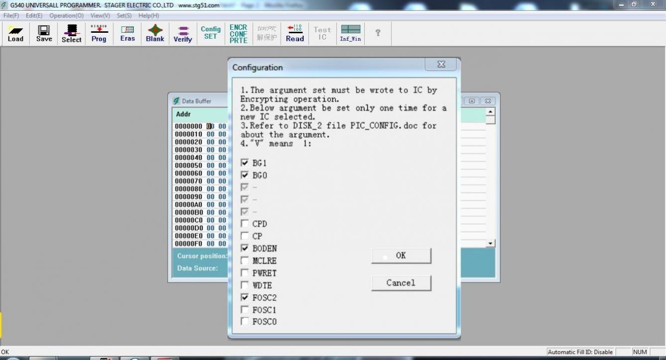

    Also is these fuse settings correct?.

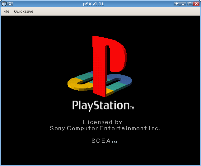

    *Update* We think we found the OSCAL value which we think is "23 24" at Address line "00007F0" so he entered that in the same address line after loading the hex and he recorded the pic and installed it into the psx and he was frozen at this screen. If it booted a backup to this screen i believe the pic was burned correctly?. Maybe it was the media he was using.

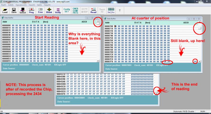

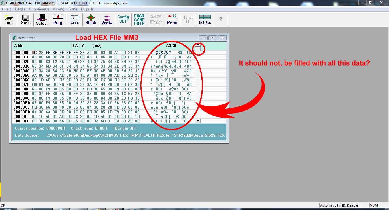

    "Another update" When he re-read the pic in his software it showed all 0000's pretty much all blank even in the ASCII line and the only thing was left was "24 34"... the suspected OSSCAL value.
