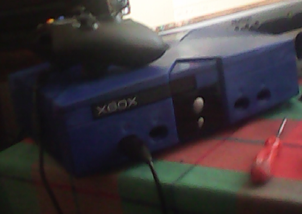

    So,after my fat PS2 died from a shorted PS1 fuse (which was too small for my ALMIGHTY 40W soldering iron)I was again on the hunt of modding a system.
    This time I decided to change the platform,generally because the PS2 is limited in what it can emulate (for example it can't do N64)and because I find it kinda fragile.
    So,I went with the Xbox. Now,I had 3 empty cases,2 DVD drives (Hitachi-LG and Samsung),one controller and a dead 1.0 motherboard and a chopped video cable (which I fixed).
    "Why did you choose a dead motherboard?" you'll ask. Well,it's a space filler until 18th August,when I'll replace it with a 1.3-1.5 motherboard/HDD combo (no idea what month and day it is but I know it's made in 2003 if that helps).
    So far the case has been done,painted it blue except front panel and DVD drive.
    Other mods that I will do to the new mobo/hdd combo:
    -Softmod (see the question below about it please)
    -1 USB port (I don't need more than one since I won't use Linux)
    -maybe white leds if I can find some old devices with white leds
    -EEPROM backup for a Seagate ST310211A HDD (keeping it on stock levels)
    No TSOP since I already said my soldering iron is 40W so I can't do that. (last motherboard I tried the mod on died because of the soldering iron)
    Now,on to the question:
    I'll be softmodding using the hotswap method. Do I need the EEPROM of the Xbox if I use this method,or not?
    Fact about this project:It first was to be called "Raven's BlueBox"(based on my new avatar) but that title got scrapped. Instead,the softmod dashboard will use a custom theme with that name.
    For the moment,a picture of the Xbox sitting idle.(motherboard inside is dead)
