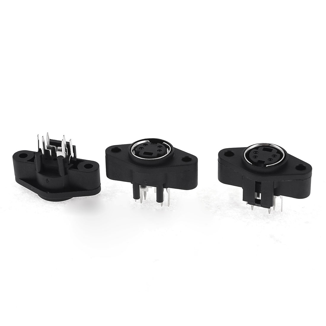

    Can someone tell me where to find the S-video jack with mount?
