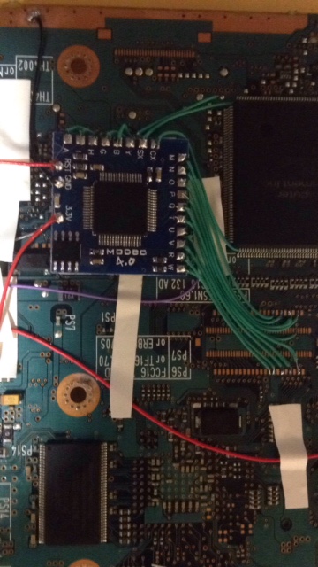

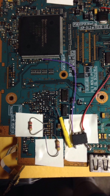

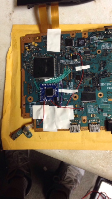

    I had a hd connect sitting around so decided to install it on my day off. Set up a 160 gb ide harddrive with it and a patched version of hdloader for v12's. The pic fix will shut the ps-2 off before the mechacon crash's and the resistors should help prevent laser burnout when using crappy media. I haven't tested it yet so hopefully it all work's.

    Weren't the resistors going to cause read issues, I thought the reason burnt media damaged optical pickups was purely from MECHACON crashing..?
    So having resistors will just make the OP work harder....
  3. Bad_Ad84
    1,309
    Iirc, the resistors are making the values the same as later slims. So the assumption is that those are the correct values

    Will it cause read issue's. Should I remove the resistor's and just use the pic fix? I really wasn't sure what to do.
    http://i58.tinypic.com/2lnaf4l.jpg
    I used 2.0k resistor since the board has the "683"'s on Rst and a 4.7k resistor for Rsf.
    Anyway the spindle motor is bad on this ps-2. I did order a new one so have to wait to test it.
    I have always had a hard time doing the laser fix's on v12's and after looking at what voultar and jinn have done felt this would be the correct route to take.
    I'll keep you posted on how it all works when i get the motor.
    The modchip and hdconnect install do work fine I'm happy to say.
