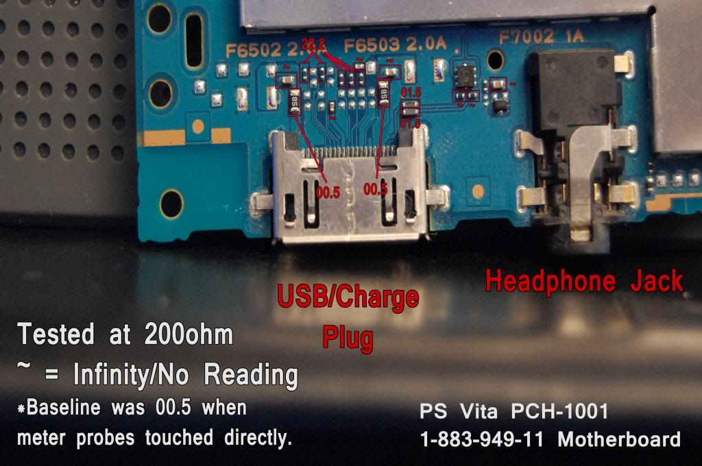

    PS Vita Motherboard Tests PCH-1001 1-883-949-11
    Alright well I spent more time looking at this Vita charging issue. I probed around with the multimeter and test light and recorded the readings I was getting and compared them to my own fully functioning Motherboard. Don't believe I saw any difference in readings anywhere.
    The only signs of power I saw while the charger was plugged it was off one of the plug socket pins toward the right side, through the black "SB" on the right side (00.5 reading), and to the little thing right above it (~ reading). It only had power on the left side of that little thing. And had power on the solder pad directly right of that thing as well. Tested this on both the bad and good motherboards and got the same results.
    Again, not super experienced with a multimeter but I'm working on it.
    I'll post the pictures but also directly link them so you can hopefully zoom in all the way to read the stuff.

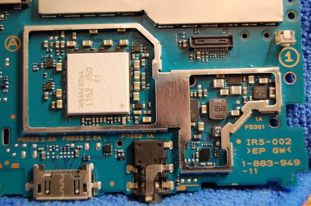

    Edit: Just found this website which has some possibly helpful pictures. The two Power Management things seems like an area I should look at I guess? Unfortunately, all these chip sections have heat shields over them that appear to be soldered on around just about the whole thing. Ehhh.
    PS Vita Teardown
    Edit 2: And we're into the Power Management department. Luckily (or not?) the shield frame is soldered or something to the board but the general shield can be carefully unclipped, which was rather tricky to do.
    ... Now what? lol Only a couple microscopic things have possible part numbers on them. Even if I was able to identify the faulty chip here, I'm not sure I'd have the skills or tools to replace it. But we're learning things so F it.
    High Res PS Vita Power Management Picture
