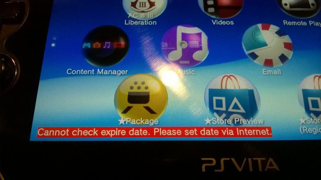

    A few people have asked regarding the internals of this device. I have opened it carefully to take a few pics for those interested. I did not break it down to the bare board, simply removed the back in order to remove the battery. On this test kit, when the battery is removed the bottom devkit/testkit message board changes messages to something regarding updating time via internet.
    [​IMG][​IMG]

  8. kyo86sg
    kyo86sg Intrepid Member
    Jul 23, 2012
    689
    34
    I see that the TEST Kit have an AC 3 liberation game? (Prototype/Beta/Retail version?)
  9. XboxSurgeon
    Nov 18, 2013
    2,109
    923
    Retail from retail cart. Installed but doesn't run. Sorry for any excitement it may have caused.
