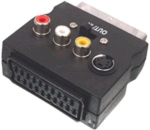

  5. ynoS XSP
    ynoS XSP Rapidly Rising Member
    Jul 26, 2015
    93
    I would say 99% chances your cable is wired with CVBS for sync.
    If you manage to grab a switchable in/out scart adapter like this...
    ... then you will be able to quickly check the type of signal coming from the yellow RCA plug.
    If you get a picture with color then its CVBS; If you get a picture but in black and white then it's Luma.
    (Of course I'm assuming your TV/monitor accepts PAL/NTSC encoding on CVBS.)

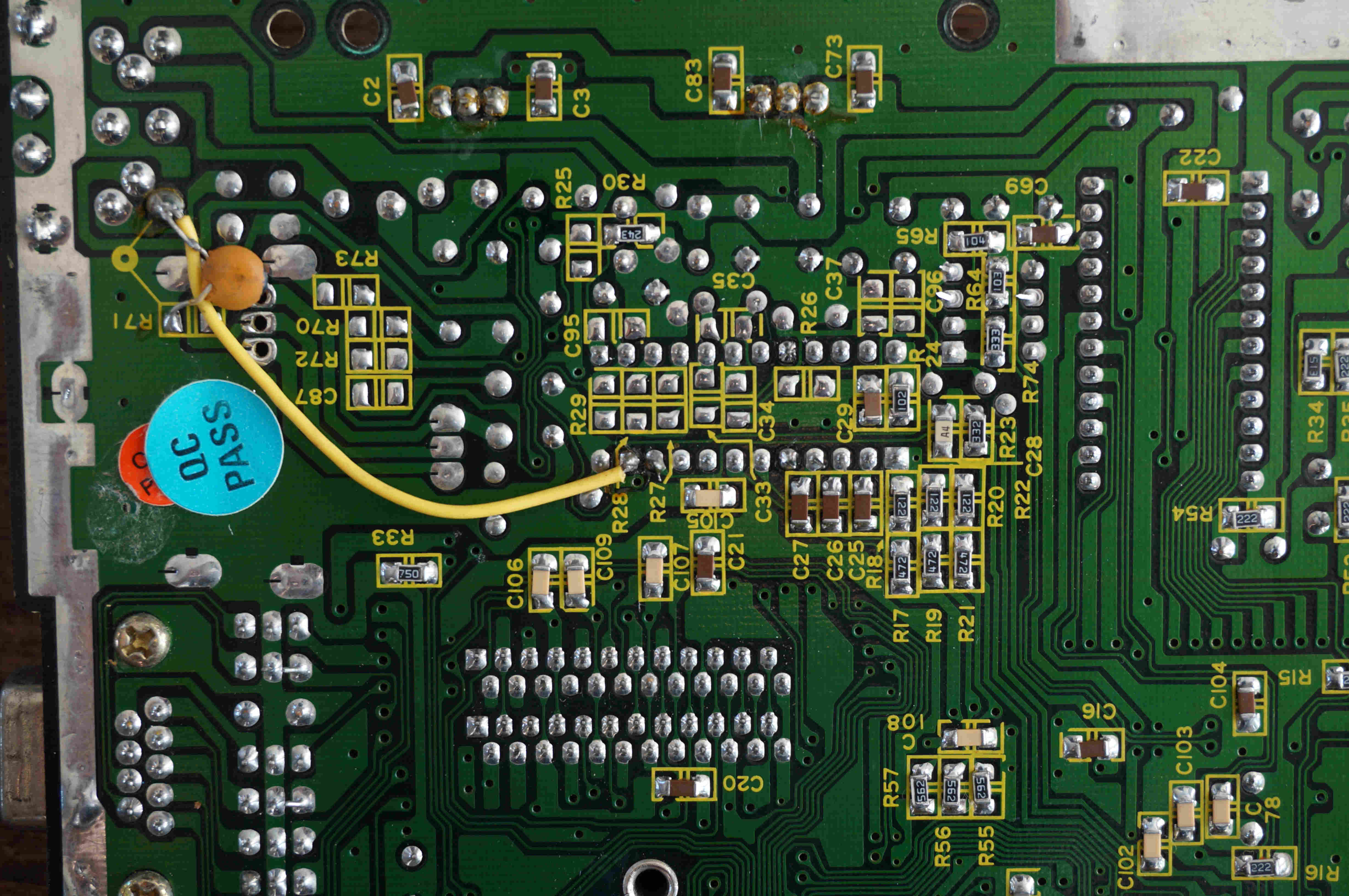

  6. Arnold101
    Arnold101 Active Member
    Aug 5, 2014
    35
    instead for a ps1 scph 1000 with pu7 mobo how i have to perform the mod? i can't get to do it
