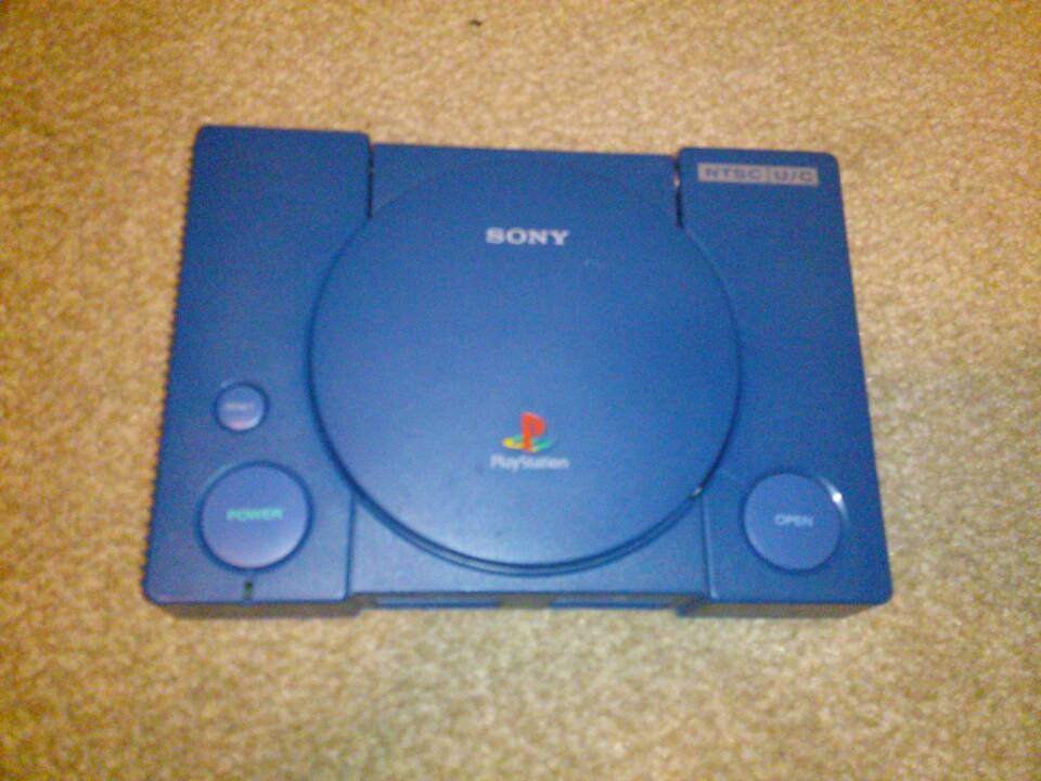

    Having a big house clearout and i discovered i had this.. However I've lost the power supply.
    From what i remember years ago, it only used to play PAL games in Black and White.
    Does anyone know where i could get one in the UK?
    I read somewhere that Sony Vaio laptop PSU might work..
    I hope to sell the console after i get the power supply.. i'm 99% sure it works but i need that certainty to get max asking price

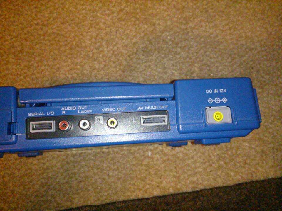

    You can swap the PSU for a retail one. Also use a rgb lead to get colour

    If he swaps it for an internal power supply it'll definitely fetch less as it won't be original parts.
    Any 12V DC should do.

    "Any 12v will do" isnt overly helpul though, hes talking about the relatively uncommong connector it uses.

    The model # for the original psu is ZA12001GN,hope that helps.

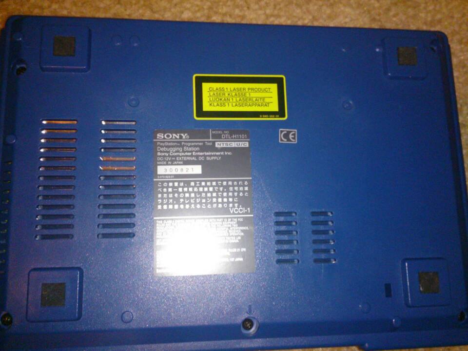

  7. hl718
    hl718 Site Soldier
    Nov 19, 2004
    2,856
    DTL-H100x = Internal PS
    DTL-H110x = External PS
    The DTL-H110x model (which OP has) is the rarer of the two.

    This model didn't come with internal PSU. However I am selling them in the UK with 2 pin euro power cable for £17 + PP.
    FWIW there are two different power supplies that they used, I have some of each.

    If I am not mistaken a DTL-H10020 (PS2 external HDD bay power supply) will work there just fine. (connects directly, no hacking needed)
    Edit: the retail counterpart SCPH-10200 would work just fine as well, but is 100-110v only.
