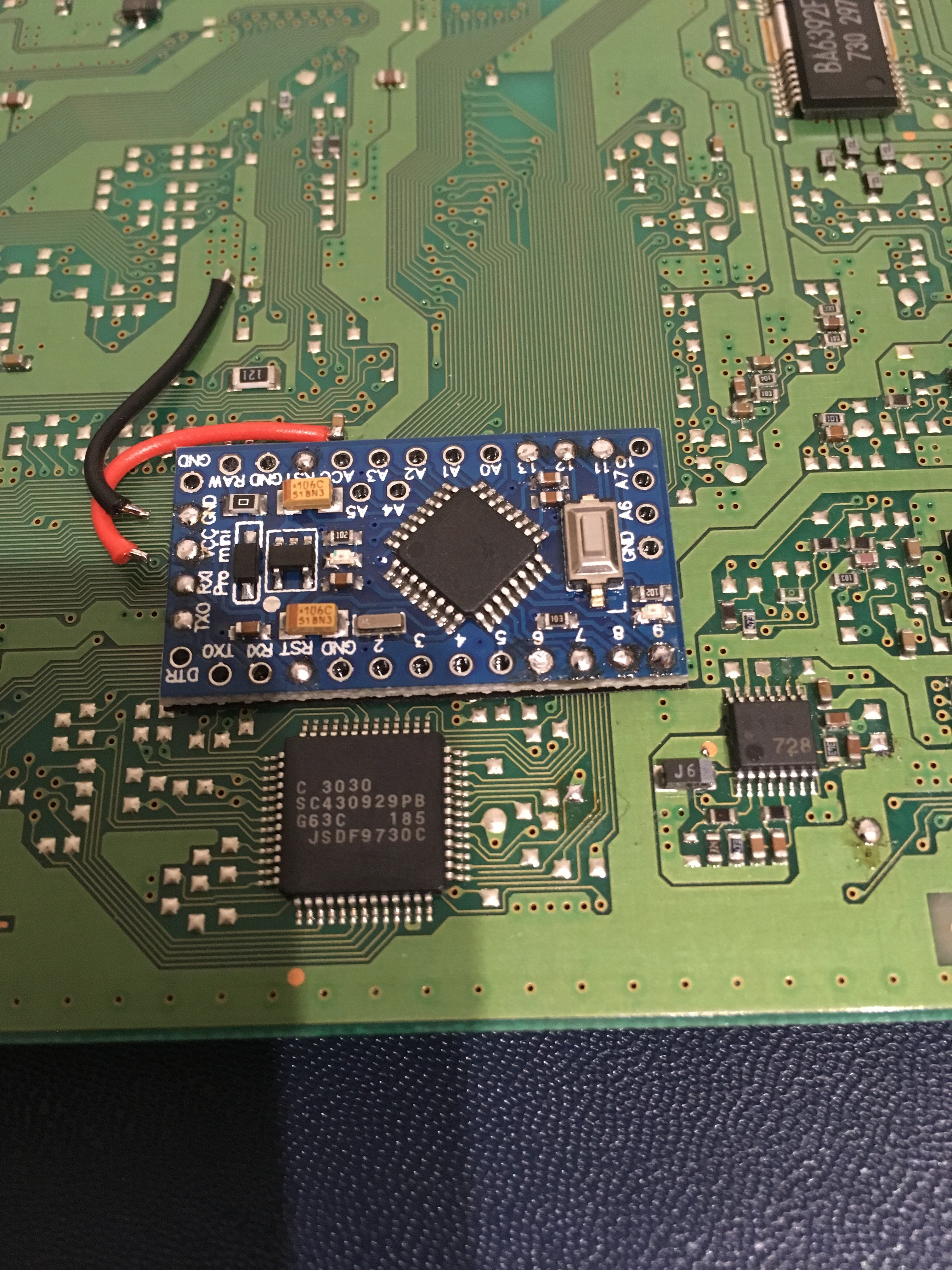

    I can't get the ISP programming to work yet again.
    EDIT2: Nevermind, got it working. Entirely my own fault, forgot to use "upload using programmer" rather than just "upload" >_< I should really write down the process of doing this... But at least the USBtinyISP I just ordered off ebay should make this a bit less easier to wire up in the future :p
    I'll get the PsNee installed tomorrow :)

    I guess I don't have the same issue after all.
    I tried rama's suggestion. But after reuploading the altered code to the Arduino and cutting the trace on the motherboard, the PS1 didn't want to read anything.
    So today I tried installing the PsNee (with unaltered code) on my JAP motherboard. I swapped the BIOS for the PAL one so I don't have to deal with bootdiscs, and the results are the same. The one game that didn't work on the PAL motherboard doesn't work here either. Every other game still does.
    The game in question is Symphony of the Night, that I just bought on ebay. The seller gave me a full refund, but had it been a hardware issue I would of course have re-refunded the money. The symptoms were so similar to the OP, that I expected this was the case.

    Weird that it didn't work for me then. The connection between pin 17 and the '723' chip was definitely cut. Maybe I messed up when I pasted the extra line into the code.
    No matter though, as it clearly wasn't a hardware issue here. The disc just don't work. I'm pretty sure it's been resurfaced too.
