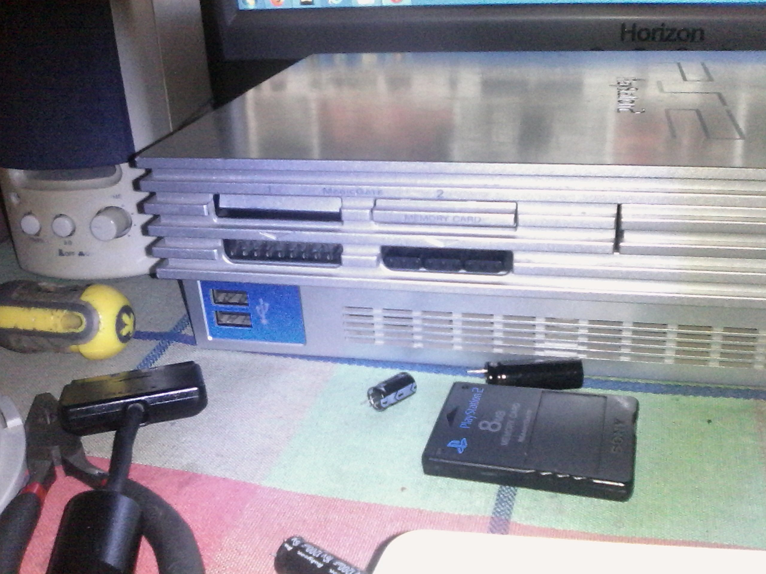

    Maybe I'll try another MC/controller PCB (this one that the console came with is in very bad shape - protective plastic parts from the controller port 1 were ripped off,so only the pins remain...) and see if it works. As for the power button it's fine. This console hasn't been stored in a place where corrosion would be produced (so not a humid environment). Maybe it happened because I got it on a rainy day? The console was pretty wet (the guy I've got the console from tried his best to protect it from rain but nevertheless it was still wet) so maybe that may have corroded the exposed pins.
    I have some pictures of the pins in question and of the other MC/Controller assembly,they're in quite bad quality. I'll post them,maybe someone can see the pins. (I did)
    EDIT:Added the pics.

  7. elmagicochrisg
    elmagicochrisg Rising Member
    Mar 22, 2012
    54
    o_O
    Well yeah, I'm pretty sure replacing the controller ports on the console will do the trick on this one... lol

  8. NeC5552
    NeC5552 All your skullz are belong to us.
    Nov 24, 2013
    332
    Yeah,apparently replacing the ports did the trick. I could play FR3 and NFS:Most Wanted without the controller cutting at all.
