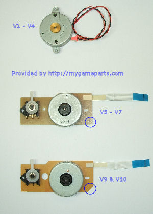

  14. Bad_Ad84
    1,309
    v5 - v8 have the same motor and board.
    Also v9 and v10 have same motor, but on a different board.
    v1 - v4 I believe have the same motor, but has wires soldered to it and its mounted via some screws. But again, this should still fit if you solder it into the original board. I cant find any decent pictures to compare against though.
    The 2 motors I have are from 39003 consoles and are different (but compatible) motors.
  15. Mord.Fustang
    Feb 17, 2013
    818
    182
    I have one that matches V9/V10 version in the pic. Seems it may also work in V5-V7. PM me if interested in getting it.
