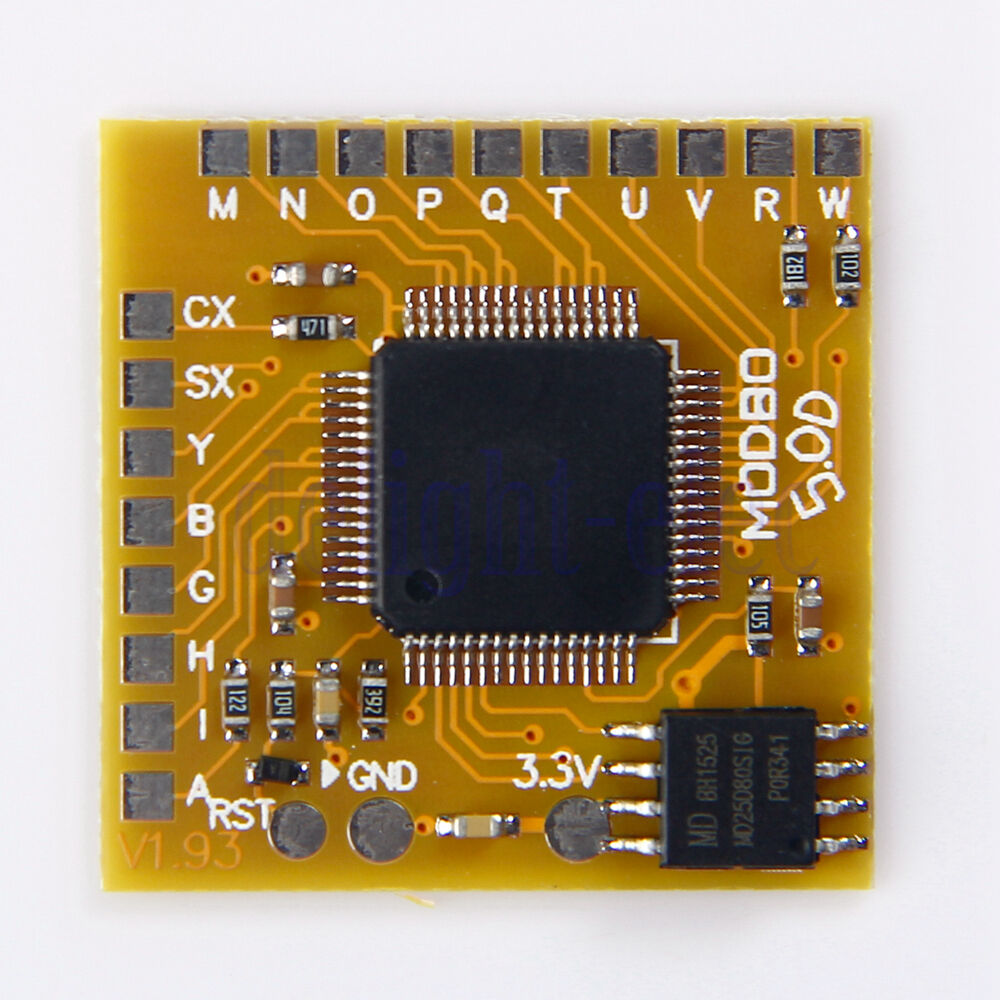

    Looking at modbo 4.0 chips on aliexpress, I can't find any 1.93's.. are the 1.99 really that bad?
    All I can find are "modbo 5.0 1.93" Are they just a pile of crap?

    They're most of what is available now unless you want to spend a lot. You can also easily find the Modbo v4's and 745's on Ebay and AliExpress though. They seem to both have a unique little feature such as the 5.0D has USB boot and the 4.0 has NIC boot (I think). Also the 745 isn't supposed to need a CX point I believe but all of the pictures that I have seen still seem to have it on there.
    Here's a 1.93 if you still need one:
    http://www.ebay.com/itm/MODBO5-0-V1...611800?hash=item2104cf3f58:g:iTAAAOSwl9BWMfQe
