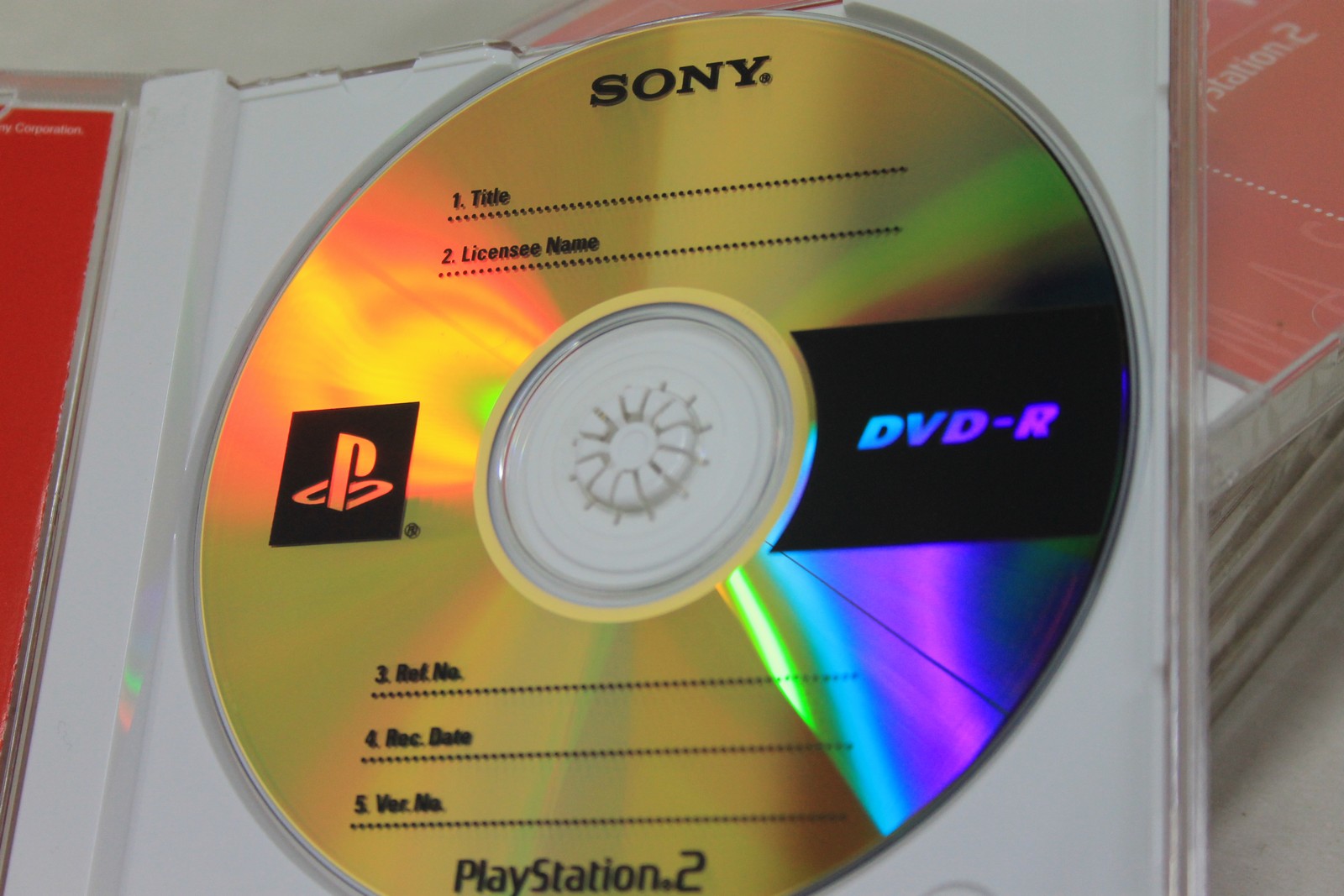

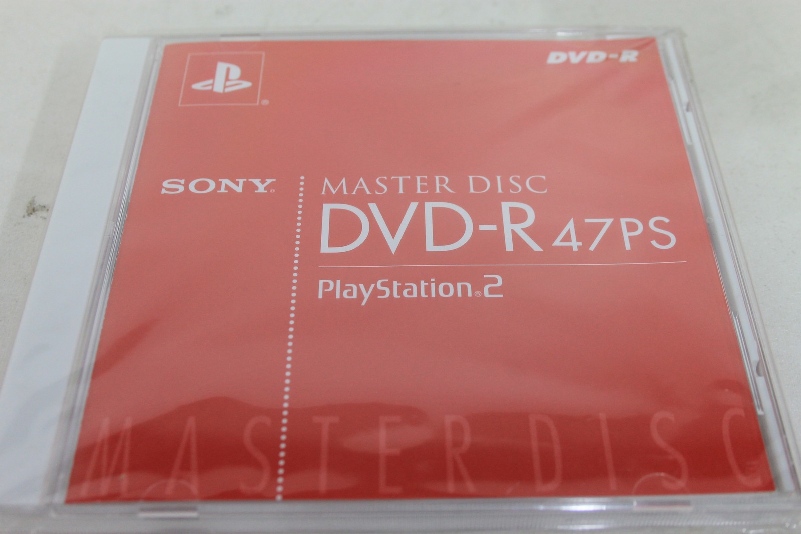

    I just got hold of a few of these discs, yet they are not recognized by my PC Pioneer drive & Imgburn (Incompatible media installed) so wondered is there a way of using these with conventional hardware or I'm I stuck with these?
    I know Sony mastered their in-house QA discs with these using CD/DVD generator via standalone burners, yet I was under the impression that these discs were just a typical brand of DVD-R with just their company logo and product name printed on them. Do these use a special disc ID that is only recognized with Sony approved QA burners?

    krisk, can i get a high rez scan of that disk? im not sure as to why it wouldn't load on a standard dvd-r burner unless you need one of a specific vintage....

    I'll try and get some up later, if it helps. I just tried one in my old XP pc with another Pioneer 118 drive and imgburn detected the disc showing "Taiyo Yuden" as the disc ID, yet nothing could be written to the disc (disc not empty message) even though the discs are brand and new factory sealed.

    This is the info I have managed to grab from Imgburn using a old burner on XP.
    Write option shows this:
    PIONEER DVD-RW DVR-118L 1.03 (ATA)
    Current Profile: DVD-R
    Disc Information:
    Status: Complete
    State of Last Session: Complete
    Erasable: No
    Sessions: 254
    MID: TAIYOYUDEN
    Supported Write Speeds: 24x
    TOC Information:
    Session 254... (LBA: 0)
    -> Track 01 (Audio, 2009:59:68, LBA: 0 - 9044992)
    -> Track 02 (Audio, 1674:34:66, LBA: 9044993 - 16580608)
    -> LeadOut (LBA: 16580609)
    Pre-recorded Information:
    Manufacturer ID: TAIYOYUDEN
    Physical Format Information (Last Recorded):
    Disc ID: ìÿ¿ûÿÿ¾-jÿ¿-234
    Book Type: DVD+R DL
    Part Version: 13
    Disc Size: Reserved (0x05)
    Maximum Read Rate: Reserved (0x0C)
    Number of Layers: Reserved (0x07)
    Track Path: Opposite Track Path (OTP)
    Linear Density: Reserved (0x0D)
    Track Density: Reserved (0x0F)
    First Physical Sector of Data Area: 10,444,799
    Last Physical Sector of Data Area: 16,719,036
    Last Physical Sector in Layer 0: 12,565,941
    Performance (Write Speed):
    Descriptor 1...
    -> B0: 0x08, B1: 0x00, B2: 0x00, B3: 0x00
    -> EL: 2298496 (0x00231280)
    -> RS: 22,160 KB/s (16x) - WS: 33,240 KB/s (24x)
    Read disc option shows
    Disc Information:
    Status: Complete
    Erasable: No
    Sessions: 254
    Supported Read Speeds: 1x, 12x
    Current Read Speed: 1x
    TOC Information:
    Book Type: DVD+R DL
    Part Version: 13
    It's showing book type as Dual Layer, which is not possible on a standard dvd-r, which makes me think this is a compatibility issue with the writer or a combination of the disc and writer.

    That's odd, DVD-R never had dual layer as far as I know. And the part number 47PS suggests it's indeed single layer. 47=4.7GB PS=PlayStation?
