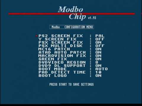

    boot into the chips setup menu, change default boot deive
    To enter the Configuration Menu, hold TRIANGLE AND CIRCLE at power on
    Select Change boot mode :)
    Circle – Boots ModBo Chip/system into PSX DVD Video mode. This forces the PS2 to either play PS1 games or DVD movies
    Triangle – Forces the system to boot the Infinity Manager
    Cross – Forces the system to bypass settings and boot to the Sony Browser with the ModBo chip enabled.
    Start – This Disables the chip. Once this is done, tap the standby button to reset the system to finish disabling the Modbo chip. To Re-enable the Modbo chip you must place the system into standby
    Select – This forces a Fast boot on PS2 games. Basically skipping the startup animation and Playstaion 2 Logo on disc boot
    R1 – This boots a homebrew ELF file from the first memory card (mc0:/BOOT/BOOT.ELF)
    L1 – This boots a homebrew ELF file from the hard drive if installed (hdd0:/__boot/boot.elf)
    Hope this helps

    Thanks a lot! That certainly helped to get it to boot directly to the browser.
    Unfortunately, not so much luck getting the unit to actually play games.
    Backup games are sometimes not recognized at all (no disk), sometimes recognized as DVD-Video and in fact, even official games don't play. Official ones are recognized as "PS2" sometimes, but when I start them I get a message "there is no data" on the screen. I'm not sure they did work before the modchip install either, to be honest. Anything obvious that I might be overlooking or could this very well be a bad laser? This is a PAL v15.
    Edit: the 'H' pad is connected.
