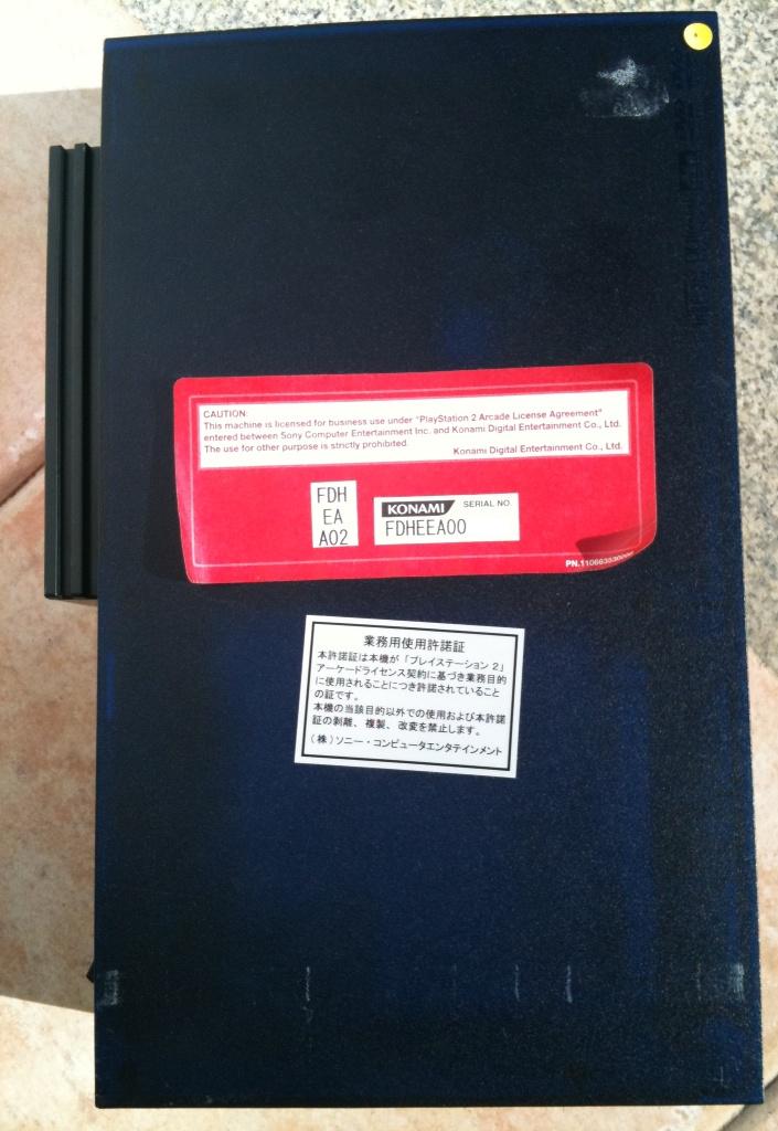

    does anyone knows the original structure of the ps2 hdd ?
    i got a Supernova ps2 arcade board with a faulty hdd
