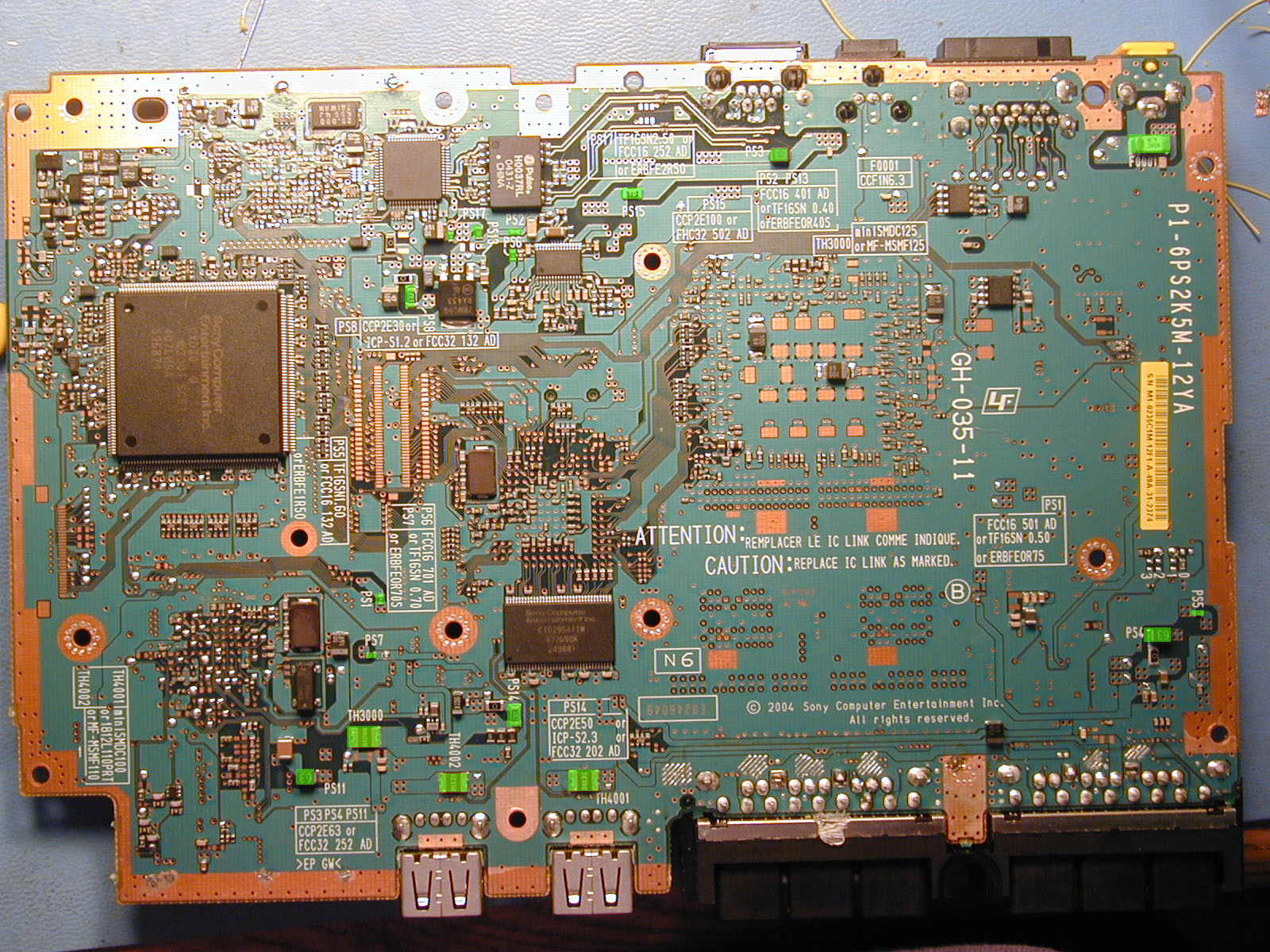

    Hi,
    I have the above PS2 slim in and the disk does not spin. The laser moves and the laser is working (red dot).
    I've removed the lid and pressed the two lid switches the laser moved down to the centre and lights up but the disk motor doesn't even twitch. The drive motor is free no binding or shot bearings.
    I'm sure these suffer from an drive motor IC failure not sure if this is applicable to this version of PS2.
    Any one fixed or had this issue before?
