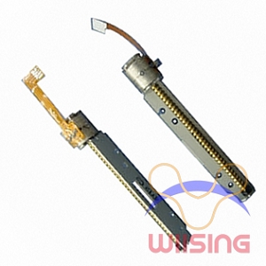

    Maybe it's the worm motor for that moves the laser unit to and from center of the drive?
    I damaged mine on my SCPH-77001 and had to buy another one. If I recall well, I bought mine for less than $5USD shipped.
    You could also try to remove, disassemble and clean that part. It's rather easy but you've got to be careful not to lose the spring in it.
    But it makes me think that the symptoms you are describing could maybe more relate to the switch in the railing system that gets pushed when the laser unit reach the center. Maybe you damaged that part. It's a small momentary switch that will indicate the system the laser can't go any further to the center and thus will stop the worm motor from spinning in vain and grinding the plastic guides on the laser unit.

    The worm gear/motor/thing works fine, it keeps moving the laser towards the motor and the plastic catch thing for the laser just keeps skipping over it because it can't go any further. The only thing I did to the PS2 is press on the back lid sensor a bit where there was electrical tape. Then I put it all back together and I turned it on a minute later and it started doing it.
