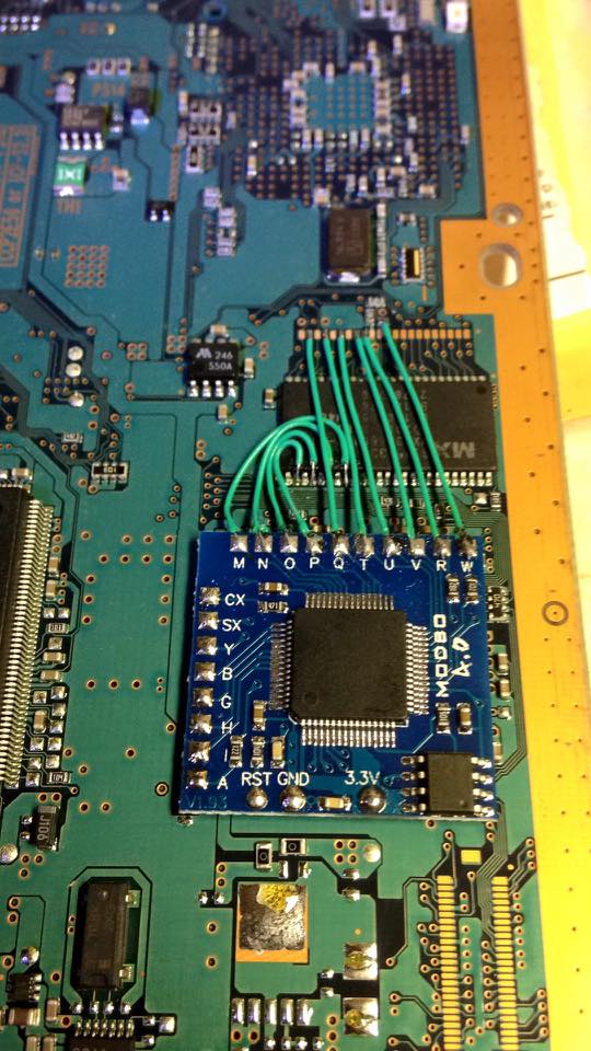

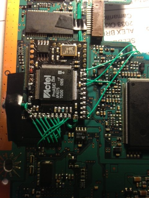

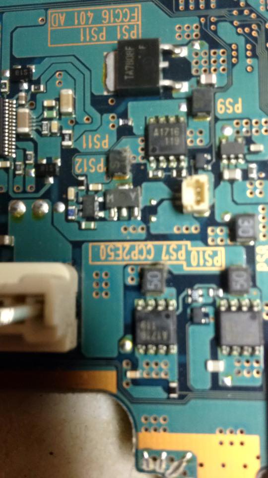

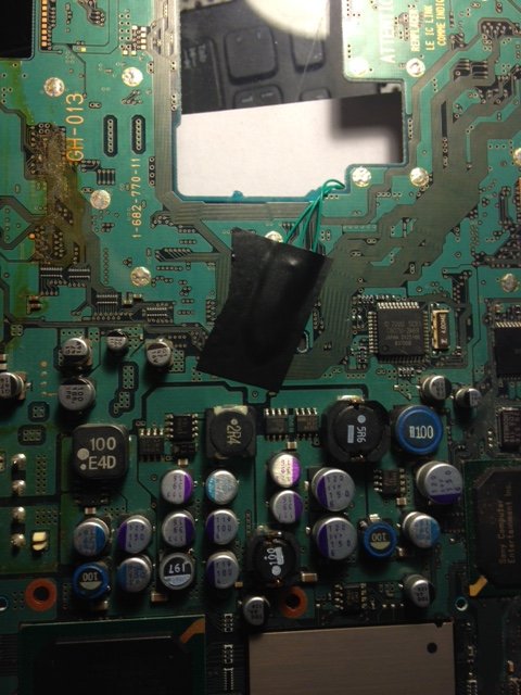

    Working on a ps2 for a friend. I had a issue with the hard drive not being detected. It ended up being ps7, ps9 and ps10 fuse for 5v and 12v power to hard drive. 13321791_10209801556575457_3352588854040370922_n.jpg 13319808_10209801556735461_3934285345450833031_n.jpg 13331087_10209801556895465_7017017808562148980_n.jpg 13315785_10209802134189897_2746296235039928199_n.jpg

    Swap electrical tape for kapton, makes it look a bit nicer and there is no residue (also kapton doesn't shrink like electrical tape)

    Yeah your right. I got 3 huge rolls of black electrical tape from my neighbor so I just use it. I'll pick up some kapton tape though. Thanks for the tip.
