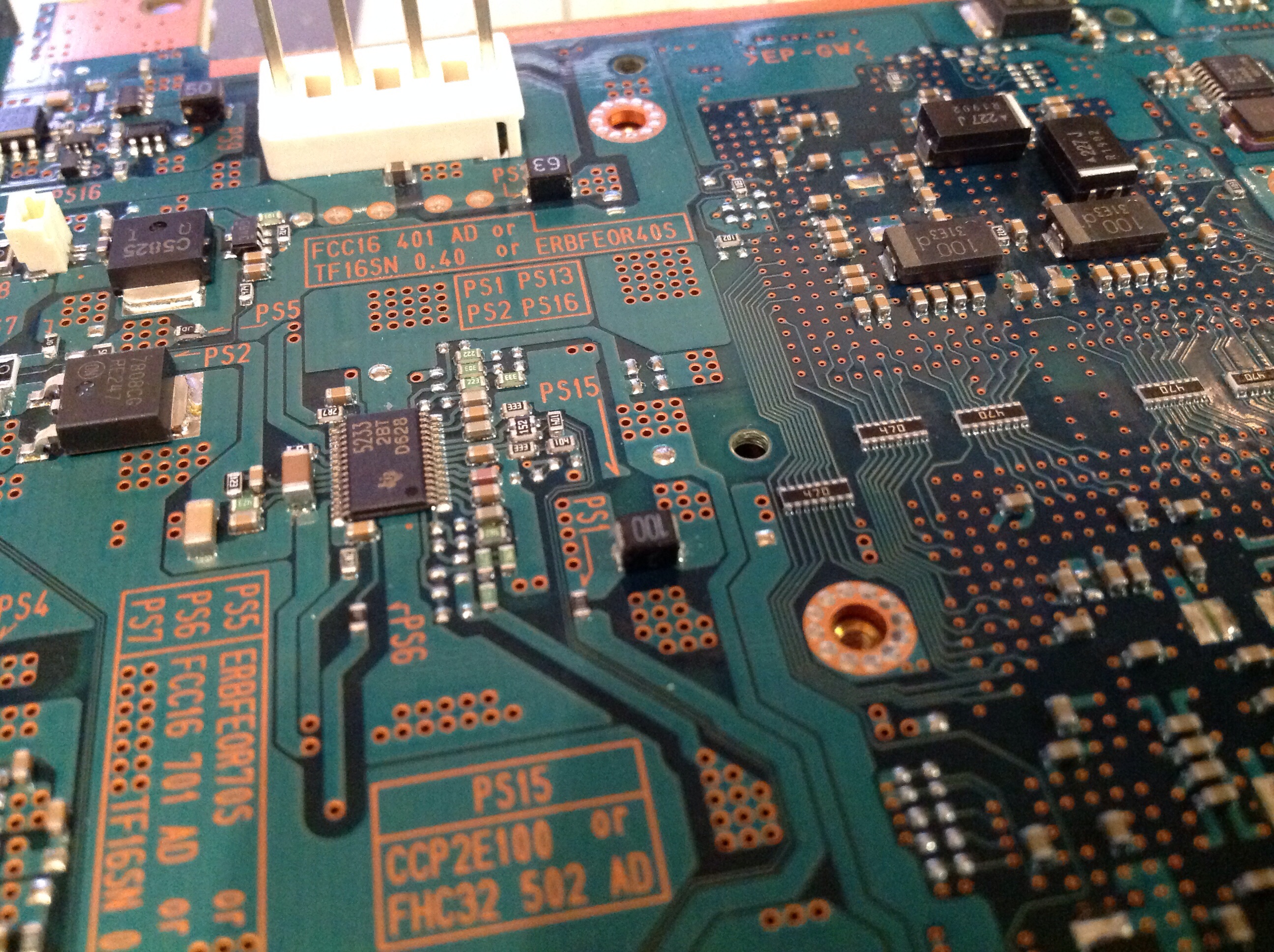

    OK, I've disassembled. After checking all the ICs I have found PS15 (an smb) to be dead. For The 'emotion engine' apparently!
    EDIT:
    I've replaced the ps15 with a pico fuse - and we have power again.
    however (!) I have now coincidentally run into a failed USB port, which when you try to plug in or adjust the port, it forces the whole console to switch off!
    not sure what can be done short of swapping them out?
    i picked up another earlier 3XXX model today, with network adapter, so still not giving up on the HDD - will probably risk reinstalling it.
