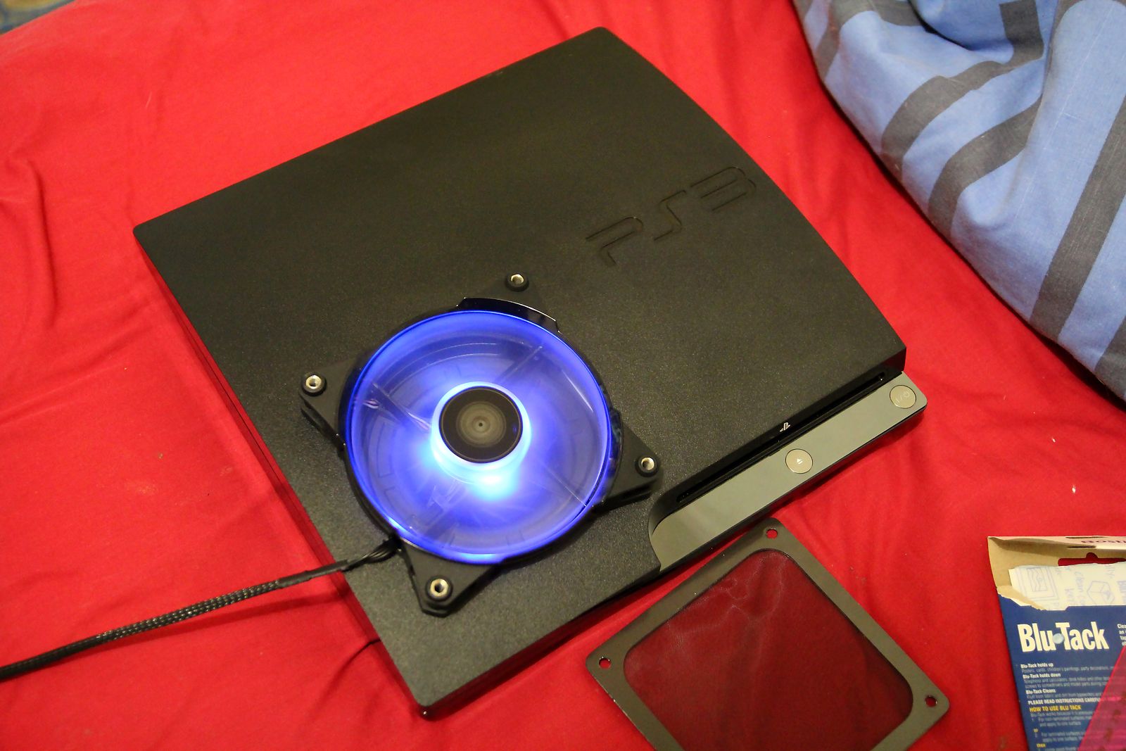

    i do 3 things with my Slim PS3's ...............
    -increase than internal fan speed to 70%
    -my own external fan mod
    -replace the Thermal Paste with Arctic Silver 5
    the result is they run at around 40 degrees Celsius , if i dont use the external fan it runs around 50. With no modding the PS3's are hot as hell to touch underneath but after the mod's its just slightly warm.
    from start to finish the external mod takes around 2 hours to do

  8. Armorant
    Armorant Spirited Member
    Sep 13, 2014
    187
    57
    70% speed, It sounds crazy, really. It must be damn loud and annoying to hear for hours. Glad that someone made all he could to make the coolest PS3 system, but whats the point in 40 degrees? My friend made almost the same thing with FAT model. He cut out part of the bottom to install two tower-like PC coolers. 33 degrees. But it looks ugly and can be placed only vertical.
