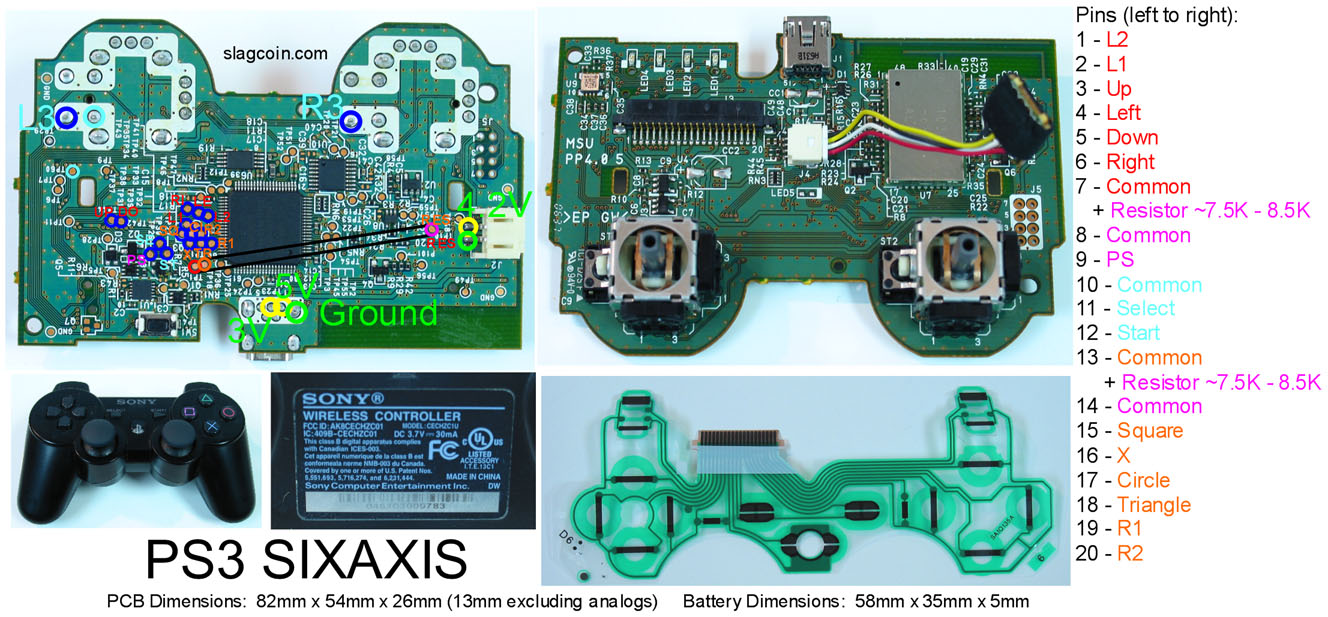

    holy shit , i just opened the controller and there are no rumble motors.........is that normal for some PS3 controllers ?
    it does however have a Toshiba chip
  7. rso
    Mar 26, 2010
    2,190
    447
    Iirc the very first model ("SixAxis") did not have rumble...? Bit weird for a slim to come with one of those though. If it says "DualShock" it should definitely have them.
    s8n likes this.
  8. s8n
    s8n Enthusiastic Member
    Dec 10, 2011
    524
    74
    interesting , the PS3 came with 2 controllers. The one i'm talking about is a SixAxis as per what is labelled on it. The other controller has rumble motors as i've tested it through my PC.
    love to know more about this situation.............this seller may get a beating from me through ebay/Paypal
  9. s8n
    Dec 10, 2011
    524
    74
    it looks like your right rso being no motors in this controller , i found the below photo on slagcoin to backup your knowledge.......nice one

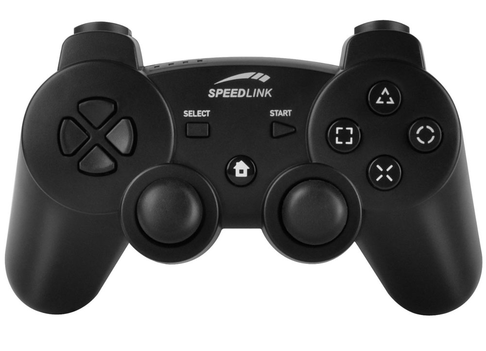

    I have the same issue with a speedlink controller with the Left analogue stick.
    Are replacement analogue sticks from ebay compatible with 3rd party controllers? [​IMG]
    The controller's name is strike fx

    Opened the controller. The look of the stick is similar to the original one,the inner workings though seem to be different (and on the cheap side of quality). I decided though not to fix the controller, as it is a cheap 3rd party controller.
    This controller was away to me by a friend that was about to throw it away
