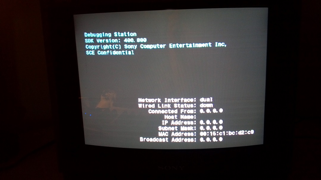

  7. Bomberhead
    Bomberhead Gutsy Member
    Oct 18, 2010
    473
    2013-11-18_08-10-05_0.jpg This thing is displaying now.
  8. Unknown-Organization
    Sep 28, 2011
    782
    Now you have got this somewhere far, Can you tell me more specifically about this corrupted data. Is it already corrupted before you try to install or is it happen to be corrupted during installing along green bar with percent number?
    Let take this into further, Is your PS3 system either PAL (Europe) or NTCS (America)
    Do you know what the original firmware it been store on you PS3 Test system before it gone?
    Are you a new owner of PS3 TEST system?

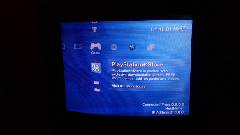

  9. Bomberhead
    Oct 18, 2010
    473
    This test unit is new to me. i know the previous 2 owners both tried to get it up on working, and could not. It is NTSC as is the sony PVM i have it running on.
    I was looking elsewhere on the internet and someone suggested holding down the power button for 2 beeps. I did, and this happened.
  10. Unknown-Organization
    Sep 28, 2011
    782
    Brilliant now you got it working. Good news. I never heard that method before.
    You are ready to do whatever you like with this system. Make sure you checked the current firmware and remember it.
    We have saved alot of time here, Congratulation.

  13. l_oliveira
    l_oliveira Officer at Arms
    Nov 24, 2007
    3,879
    245
    That causes the PS3 to "forget" the video settings and return for analog mode. If it detects HDMI link it will then communicate with the display and perform the setup.
    If a PS3 (ANY PS3) is set up for HDMI display, the ANALOG outputs will be *muted* meaning there is no image at all there.
  14. Decapicitated
    Decapicitated Site Supporter 2011-13 Lara Croft
    Apr 17, 2011
    399
    33
    Just so you know, it was not an issue with video settings. It was nothing more than the console being set in a different boot mode which is only possible on Debug consoles. Holding the power button reset it to boot in software mode (XMB). Issue is solved, can this die now?
