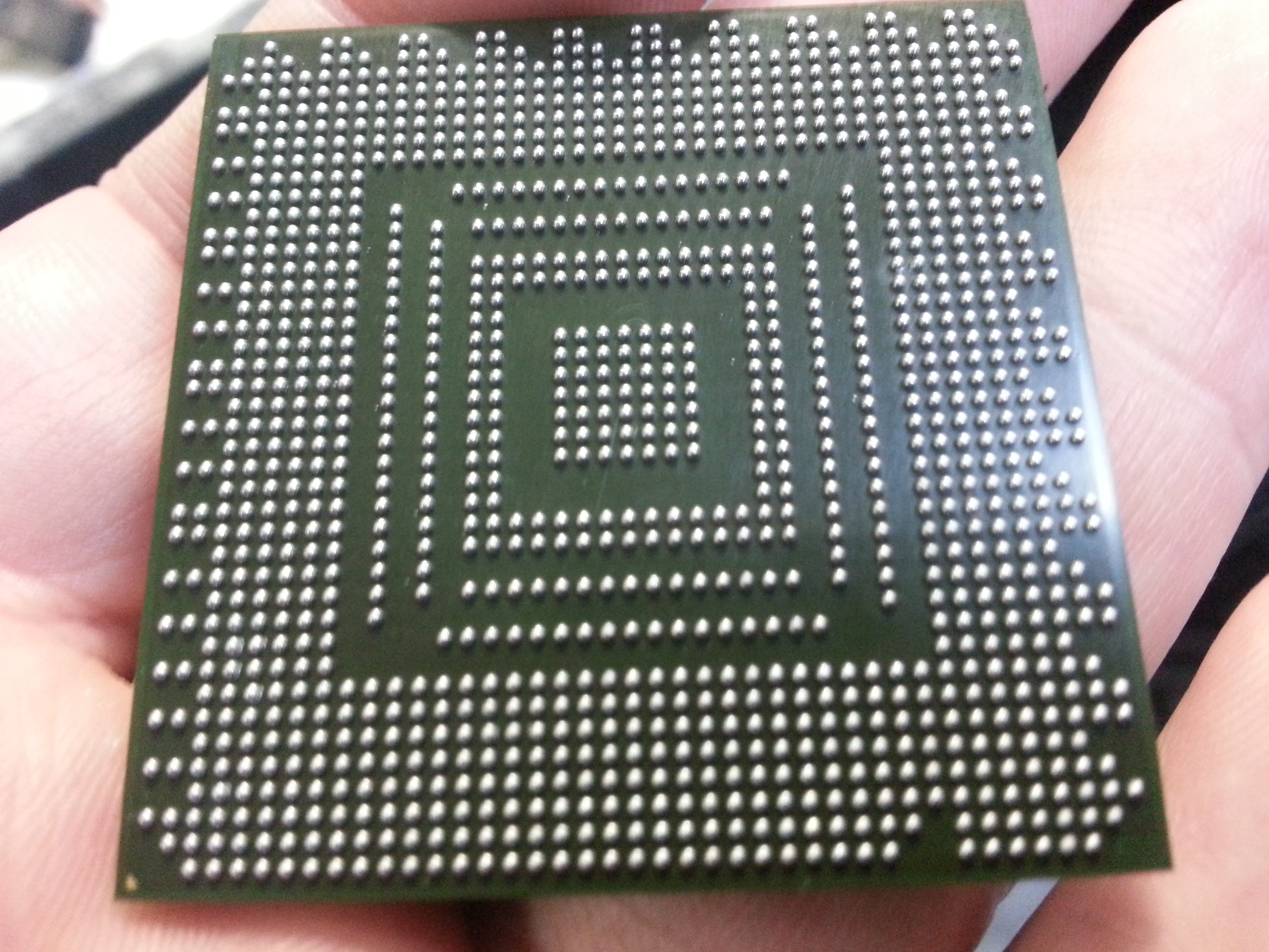

    Yeah get it reballed if you can. A lot of shops don't reball due to time and ability to do. I don't know anyone else other than myself who reballs in my area (plenty of professional heat gunners though!)
    This is what you want:
