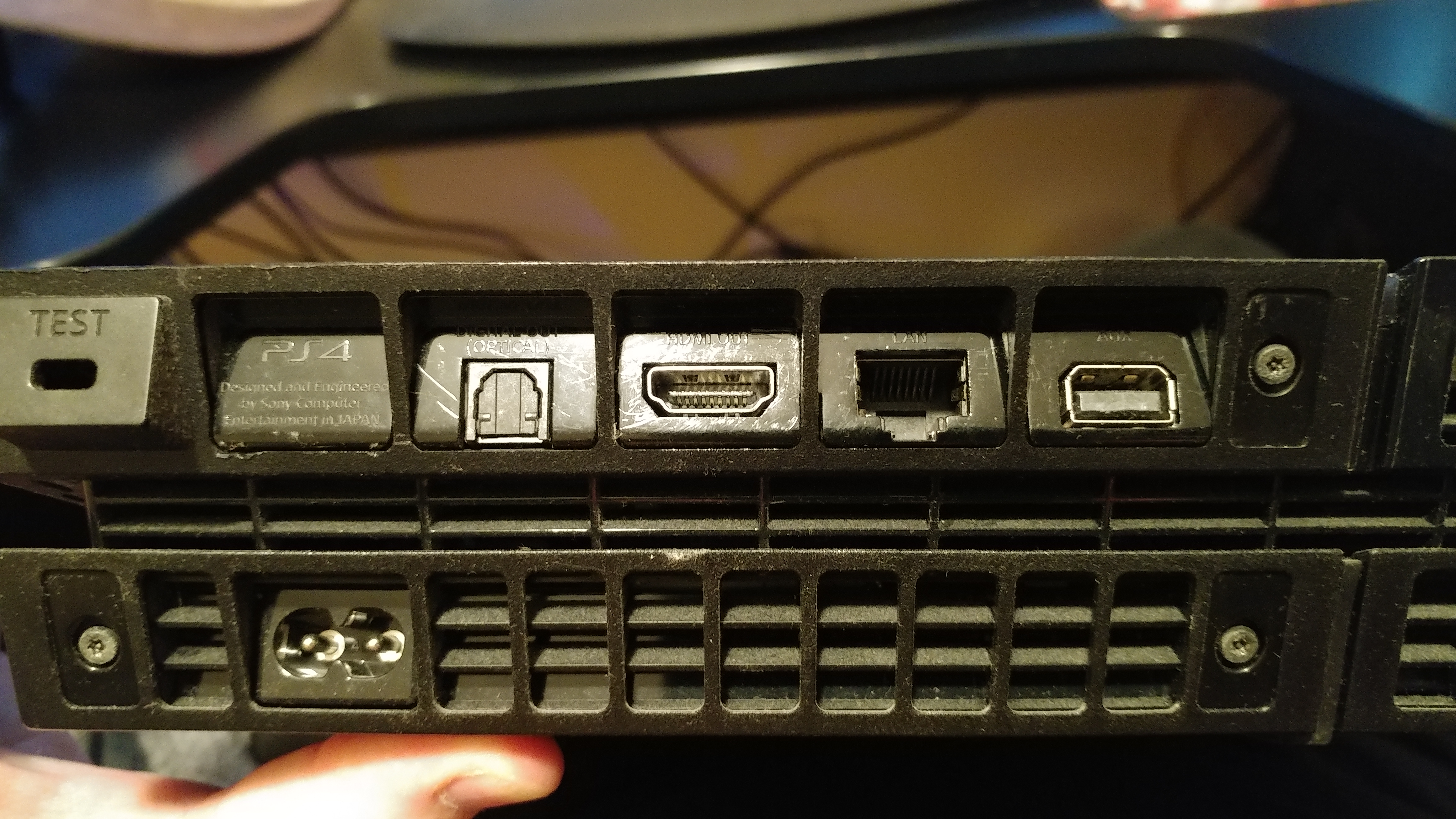

    You know what the best part is? The Testkits and Devkits have 0 issues what so ever (though sometimes the disc drive isn't connected inside for some reason). I even have a picture just for this thread to show a DUH-T1000AA HDMI port (Exterior only because I'm tired).
    It's snug fit, doesn't wiggle, and from what I can tell isn't separating or messing with the plastic.

    going by your post Pixel to me it seems the home consoles were made to break and then purchase another PS4 , i could be wrong and the HDMI port issue was a huge balls up by Sony

    Thats the same port as on a retail, I think the difference is that people move their retail units a lot. We do ask about how our customers use their units and usually the hdmi failure units have frequent flyer miles. I would expect a dev unit to be treated better and be used in a single place or moved infrequently. The ultimate failure is when the tip of the pins gets bent slightly away from the plastic tab, on next insertion those pins get pushed out the back or smashed against the back of the port. Usually that is caused by wear on the plastic tab or separation of the metal portion of the port. the port on that dev unit shows almost no use.
    By the way they fixed the later ones by securing the tips of the pins, the Cech-3000 hdmis on ps3 have the same design faults but were mounted as through hole components so they flex less.

    I would like to say that sony tends to have higher quality components or build quality on dev stuff in my experience. A DECHA00A is the same as a launch PS3 yet I rarely see them dead unless they've clearly been abused.
    That said, my PS4 testkit has an unknown history. I know the seller didnt pack it with bubblewrap and the front is cracked on one corner, but I also don't know when/who opened it. I dont know how long it was used or who owned it prior. I know it exchanged hands at least 3 times and was setup taken apart and tinkered with by all of us.
    I'm pretty sure if you tried using it, you'd notice the HDMI port on this one feels damn solid
