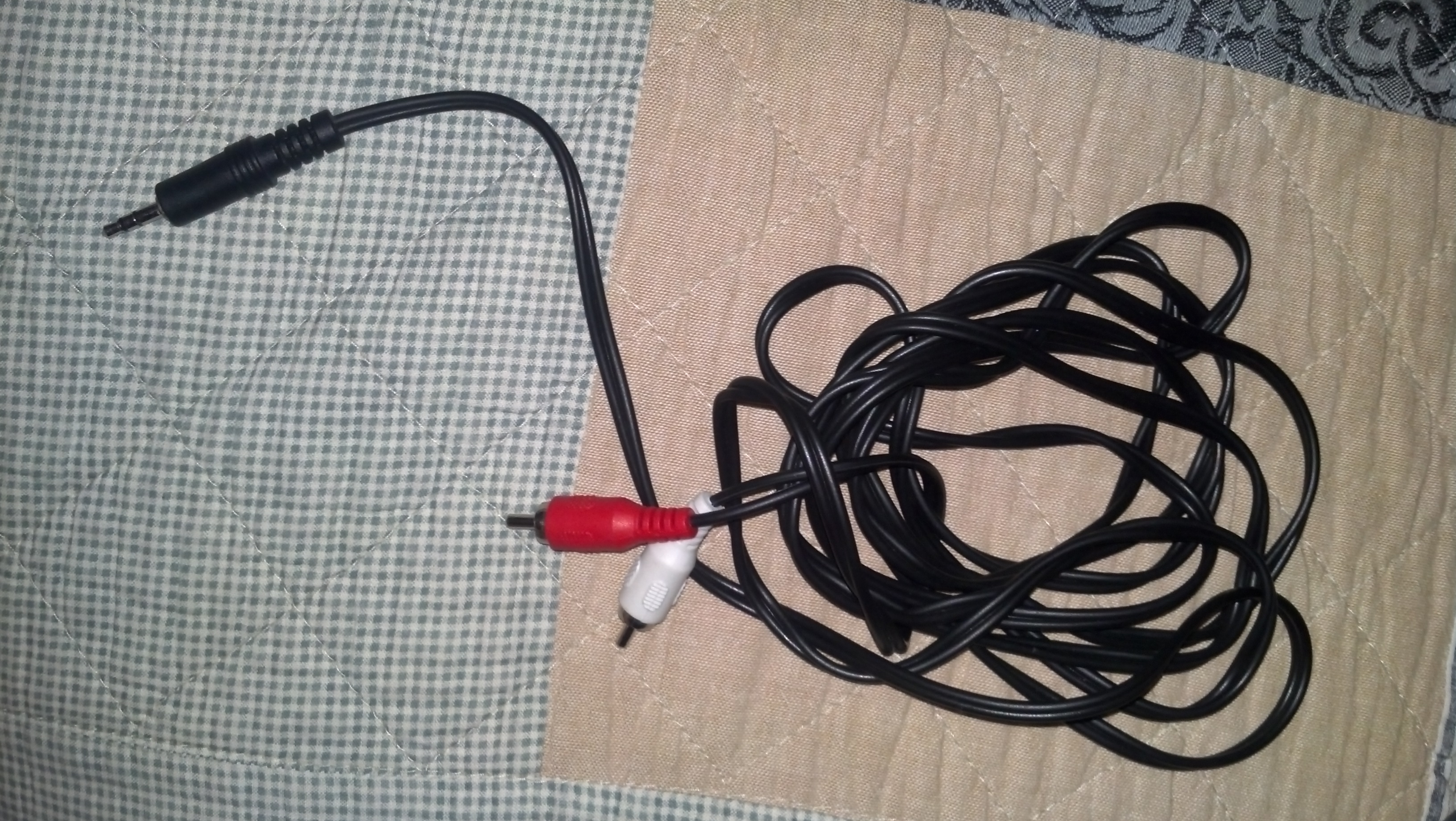

    As you might know, the PsOne LCD has an AV-in on the back, so I want to plug my Gamecube in it. I bought two cables of different brands (I thought the cable was the problem). But I'm not able to succeed. All I get is a little bit of sound & terrible video in the beginning and then the screen turns off. I tried the screen with my n64 and the same thing happens. All devices are PAL and the psone is a modchipped pal psone as well. The photo of the cable I got is below:
    I also took a 5 seconds video of the screen while the Gamecube was running: http://tinypic.com/r/2v0mt1z/8
    Please enlighten me! Thanks a dozen :)
    Note: I have no experience with modding or any sort of cable stuff, please consider that I dont have any idea about the terminology

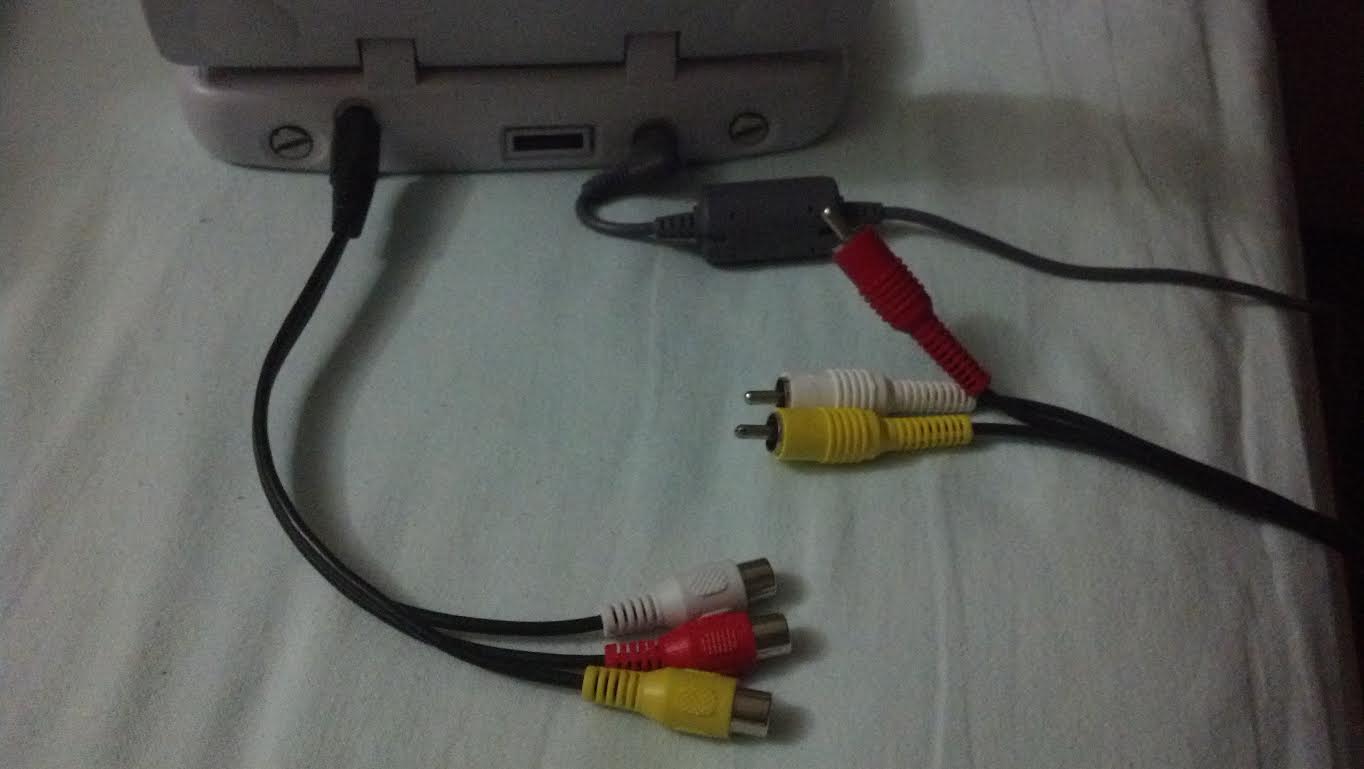

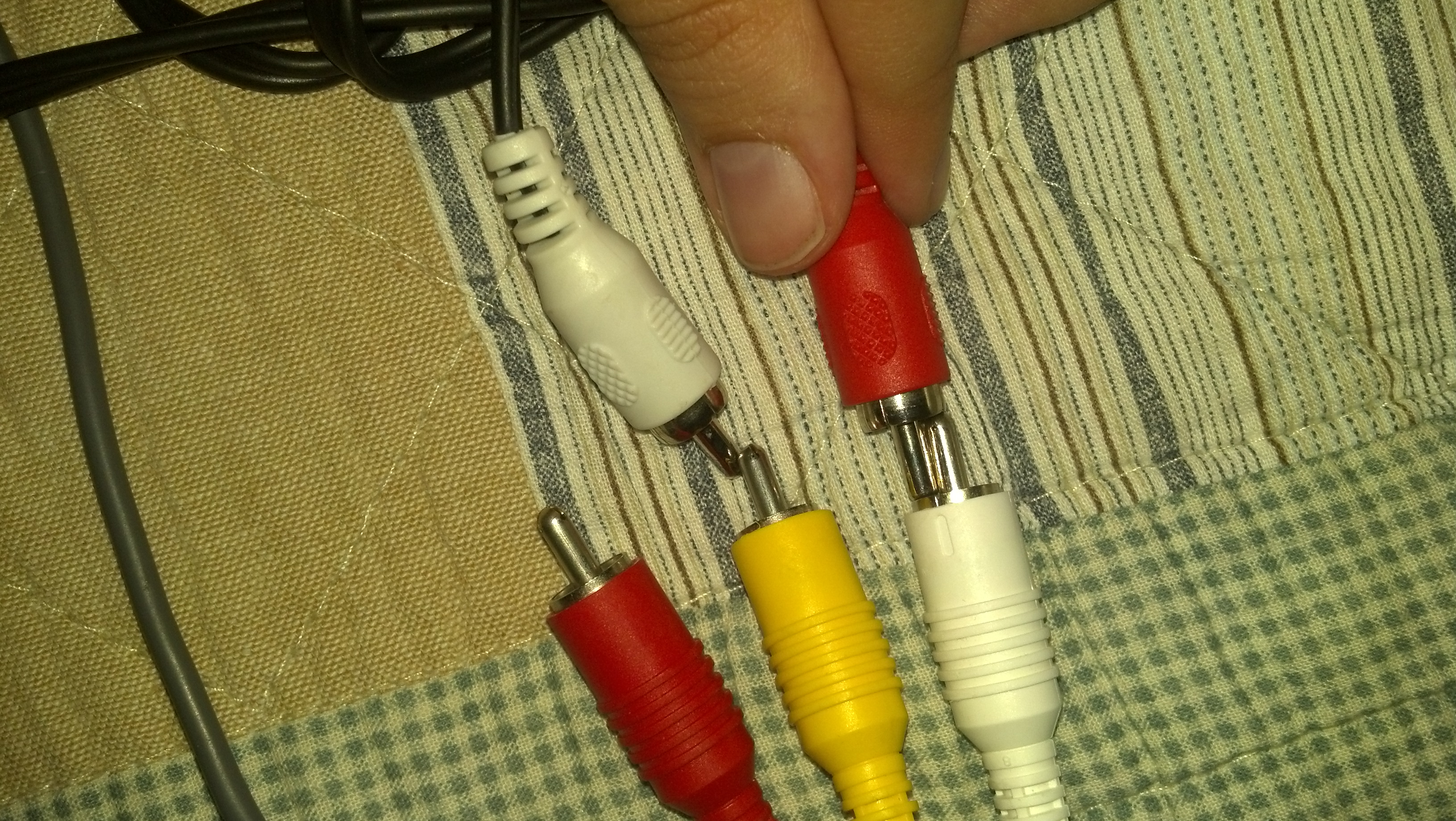

    There's a progress!!!
    I found this cable at home:
    I decided to try different combinations and somehow using this combination I got a crystal clear image!
    But the thing is that is the only position I get a good image, so is there a way I can make it more stabilized maybe using my female connectors?

    Also the way it works at the moment is a little weird. Only one sound (right or left) + the tip of the yellow cable must touch the other cable's tip. (Just like in the 2nd picture on the 6th post)
