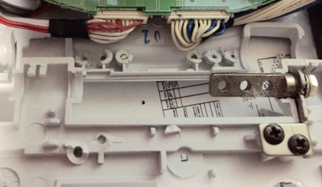

    So I scored a PSone with Official Sony LCD screen for a 5$ game trade. The good news is I was able to get it running, screen and all after some cleaning and minor repairs but...all the screw holders that keep the screen attached to the mechanism that allows you to keep the screen at the angle of choice..are busted. Every screw holder but 2 on each side (Screen and rear adapter) are broken. I don't think there's enough glue or epoxy to get it to hold. Heck, i'd have to rebuild the holders then get it all to stay in place!
    I've looked everywhere and cannot find any website that has replacement LCD screen lids. Just wondering if anyone had seen any, or even a cheap broken screen since all I need is a functioning lid. FullSizeRender (6).jpg

    Problem is, the "holders" didn't break off..they shattered..like into a bunch of tiny little pieces..there's no pieces big enough to rebuild with epoxy.

    Do what I did
    make some metal or plastic poles that sit in whats remaing of the scre wholes and epoxy them in. Then put in the hinges and epoxy the hell out of that.
    Just as strong and good as new with no visual difference.

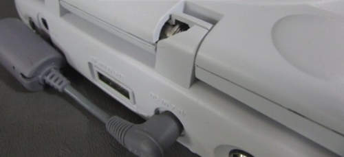

    I've recently purchased a LCD screen with a chipped hinge. I thought the chip made it not sturdy, but it also rattles. This makes me think we have the same problem. Were you able to find a solution? Thanks, any information is appreciated greatly. This is my first LCD screen. I was way too excited about it to face defeat so I'm going to take on this challenge.[​IMG]

    My issue was the plastic holders on the inside of the hinge. Nothing on the outside was broken like yours. The bad news is, the only way to get into the assembly is removing the speaker screen to access some screws, and maybe you can..But I couldn't get those off without tearing them. (can't find replacements yet, maybe i'll find white speaker cloth?)
    To fix the inside: I found some small plastic dowels at a craft store (i think they were crochet needles) and epoxied the hell out of them. Then I tapped the appropriate side screw hole it centers, screwed the lid into place and it held. I opened and closed it a few times then left it in place up open so I don't tempt fate..lol Not sure how well this would do for continuous use but seems to be holding for now

    Thanks so much for the last response. Woah dude, that's pretty crafty in a genius type of way, Well played. I'm trying to visualize how you did that (especially with a crotchet needle), but really can't. I guess the dowels acted as new holders for the hinges and you used the same screws.
    Do you think that the chip on the outside is the only problem? I was thinking the other hinge would be enough to hold it up. When I shake my screen it rattles. I'm thinking the holders shattered like yours.
