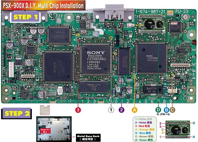

    Yes it does come with instructions, but its pretty easy..
    I changed mine around a bit, there are 3 wires to solder in and a IC clip, that is all there is to it. IF you want VCD playback then you will need to install the AV clip too (But it makes a faint buzzing noise in the left audio)
    The purple wire can be attached with a switch to maintain the original bios (Like what I did).
    Also the power connector for the chip should be de-soldered and installed on the top of the pcb (Like in my pic), otherwise it wont go back together.

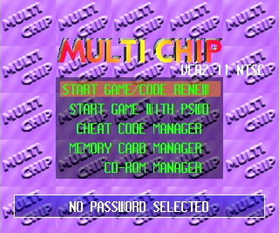

    The one he was asking about gives you this screen:
    It's not a single chip, either. It's a small PCB with an epoxy blob, and it shouldn't be confused with a "multi-x chip", which is a general name for any single-chip mod. The chip visible on the picture you enclosed is your regular multi-x chip, and on its own, it does not change the appearance of the BIOS.
    I know that the D.I.Y. Movie Cards give you a similar menu, adding the VCD option at the top, but they're huge. The Multi Chip is relatively small and it fits inside a PSOne, and besides, who's watching VCD's these days?

  12. Bad_Ad84
    1,309
    Judging from that picture:
    There are 2 glob tops
    You solder it in and it replaces the bios
    You also solder connections for the common modchip points.
    Id say the board is 2 chips, one is a modchip and the other is a bios replacement. You just need to get a dump of the bios, program it to a chip and also fit a modchip and you will end up with the same thing.
    If someone has one of these, id be interested to see it and dump it. Could make a DIY replacement

    Looking at the picture the chip is on top of the BIOS so I guess it has a socket to fit right in place.
    I wonder if the BIOS that my Chinese supplier sells have the this menu.
