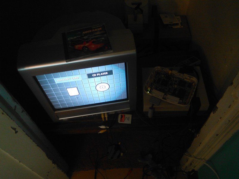

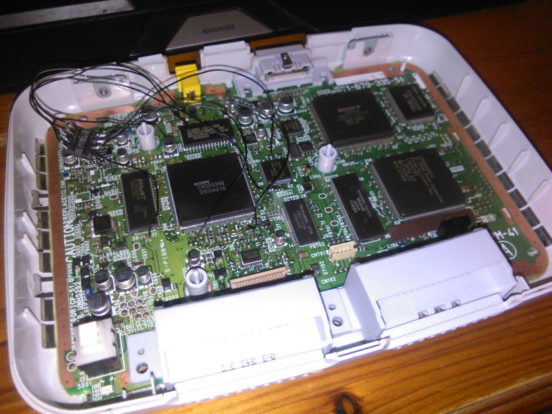

    Now first off, this isn't the usual black and white issue with PS1's (and NTSC games) I have just installed a OneChip into my SCPH-102..

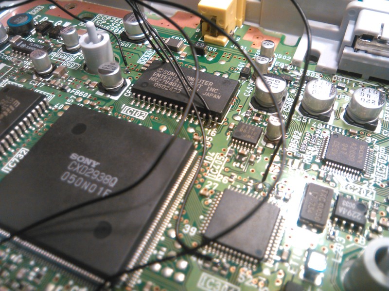

    First of all it wouldn't display anything at all on screen nor would it make any sounds. Although i could tell from the disk noises that it was loading etc. After searching here I found that IC102 can cause this problem and a simple fix is to reheat the pins. I did this and...
    We have a picture and sound! the issue now however is that the screen is constantly black and white?! NOT just in NTSC games but constantly. I did test a Japanese import of Ridge Racer and can confirm the mod chip is working.

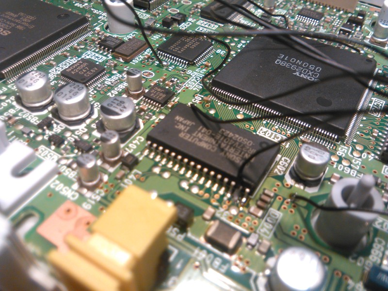

    Solved it, for some reason the chip is making my console think it is a NTSC console even during the initial boot... I did this mod to the board..
    It is now working perfectly. :D Happy days
