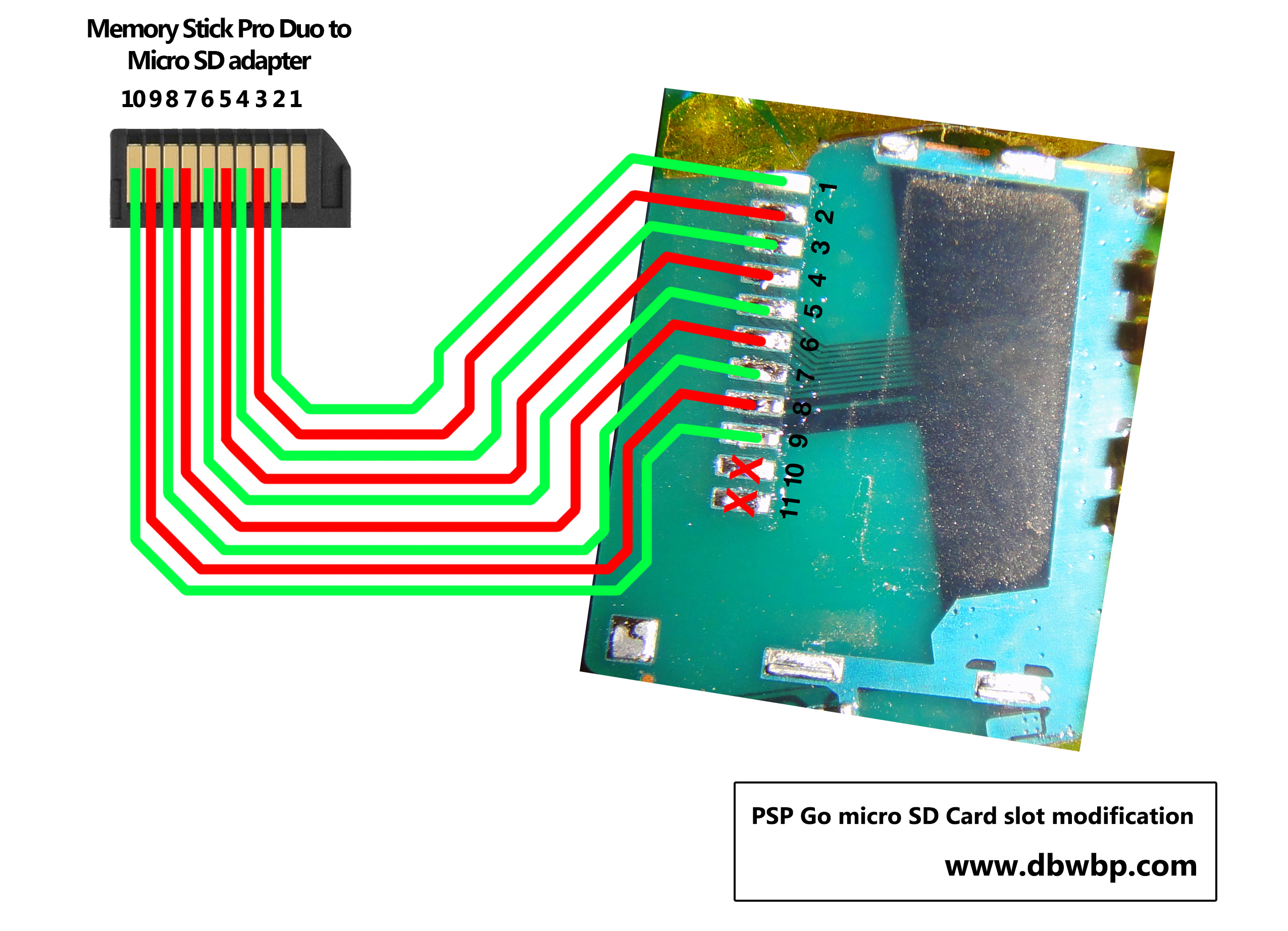

    This is a mod I had been planning on for a while, but as I'm going on vacation soon I decided to get on it.
    The work in and of itself is rather simple if you know how to solder well. Below are some pictures, and proof of the mod working with a 128gb micro sd card. I'll also like to a site where someone has done the mod and provided an extremely helpful picture for pinouts on the sd card adapter to psp go pcb.
    All you need outside of soldering skills are a micro sd to memory stick pro duo adapter, small gauge wire, and preferably a clickly micro sd card slot.
    I had originally thought about using the contact points on the top of the adapter pcb, but this made things too complicated. I was also disappointed to find the black glob on the adapter, this raised part made fitting it into the psp go a challenge. I recommend that if this is what you get, to just find another adapter.
    Putting the adapter board and the slot together.
    Soldering to the psp go pcb.
    And all put together on the board
    Had to cut out some plastics inside the slot area.
    Honestly here the clearnace for the card isnt as great as I wanted it to be. But it still functions fine if i loosen the screw holding the back plate on by a little bit.
    The card.
    And finally! All that storage on a psp go. Beautiful thing
