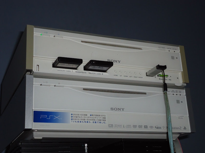

    Hello everyone.
    Better to start the story from the beginning. I have four PSX DESR's. I really like to spend my time working with PS2 consoles and of course with PSX.
    1. My very first is 5000 and it's a primary unit for all experiments. It has not two case parts: one that covers Memory Cards and etc, and the second for covering it's back with A/V, D-Terminal and others type of connectors. XMB still starts up, but when I want to return from game to the XMB by using R1+R2+L1+L2+Select+Start combination it start to hang everytime on black screen. The DVR'S laser SF-DB11 is out of working(.
    2. The second one is 7100. It still has void sticker on it and it is in great condition. Absolutely working unit. I keep it in its cardbox. For the bad times)
    3. Last buy was two junk units: 5500 and 7500.
    The 5500.
    Every time I plug in the power cord into console the red led appears, cooler starts to work and the HDD Access led starts to light (witout sparking, unblinkingly). In that time the internal HDD must start to spin out, but I can't hear it. It doesnt spin out. When I try to turn it on the PSX logo appears but there is no sound and next thing is a black screen. The FMCB card boot up and its logo appears but it doesnt react on any button to launch the ULE. 5500 has 160GB Maxtor HDD inside and it spins out when I take it out of the PSX and connect it to the 4pin PC power conector (I dont connect the IDE interface cause it might remap the HDD in Windows). But when I connect HDDs broad ribbon cable to the the PSX motherboard and starts to power on the HDD from the 4pin PC it does'nt spin. So the main problem of 5500 is that the HDD not initialize - doesnt spin at all and not cause of bad blocks. Seems it drive (and SF-DB11) works cause when I insert the 1.10 Update disk sometimes it starts to spin, but still the special service menu doesnt appears. (I dont know how the update process works and looks like). Of cource I know that I need 2.11 but I can't find it to buy. Also I use 250GB from 7500 to tru it in 5500. Same results(.
    The 7500
    It had void sticker on it. Where is no red led or any other reaction to the power. The power supply unit seems working - it has two pairs of GNDs and two pairs of 12V. The internal HDD is 250GB HITACHI HDS722525VLAT80. Cause of void sticker it is not refurbished. 7500 in a very good condition inside and with a big chance it has abolutely working DVR-ROM.
    4. I also have Update disks 1.10, 1.20, 1.31
    So the questions are:
    -How could I dump the HDDs sectors most fully and correctly and the HDDs PCB firmware?
    -Are all of the PSX have the same model? I mean I want to use 5500 or 7500 DVR-ROM in my 5000.
    -Can I use 160GB Maxtor from 5500 in my 5000 by using the 1.31 update disk? Of course firstly I have to gain the HDD dump and have to repair/change the DVR-ROM.
    -Does the 5500 and 7500 motherboards can replace each over?
    -I checked the PSXs 4pin HDD power. Seems it has 12V. But why there is no sound during the PSX logo? That problem might have the same cause as not spinings HDDs. Stabilizers?
    So, it takes almost eternity to write it, thank you for your time. \0/
