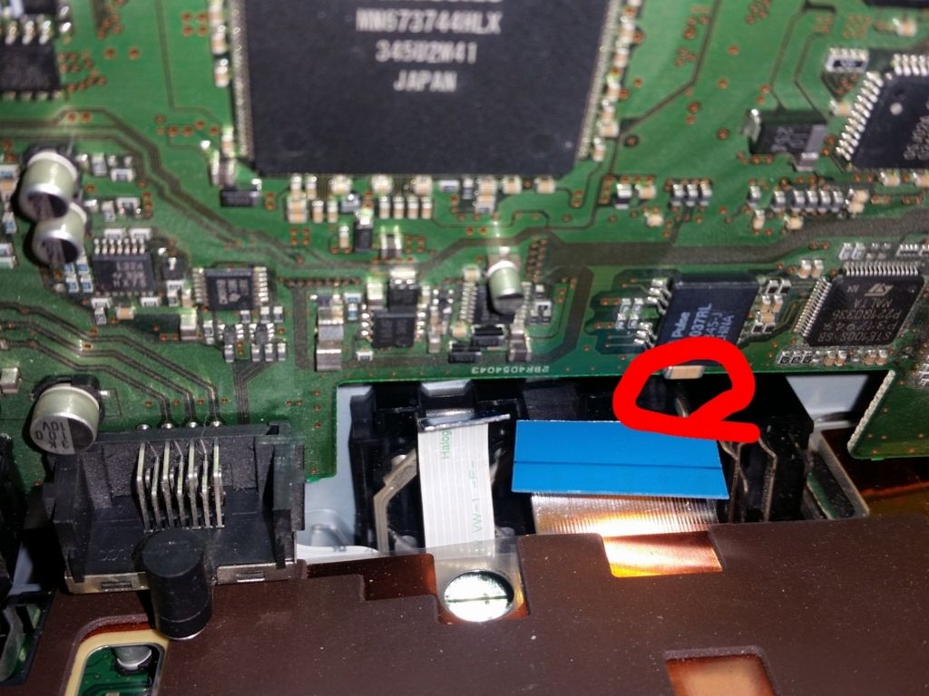

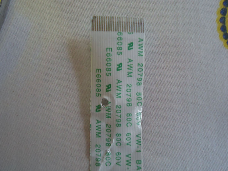

    I was a little rushed before work but I snapped some quick photos. I didn't get the front board cable picture but it looks exactly like the one in your picture. Right down to where that hole is. I have the screws that are missing in the photo. I was partway through taking it apart when I took these. If you need other angles/the other side of the board then let me know. Thanks for your help.

    The missing flatcable has a hole in it?
    That hole was made with the screw by the previous owner of my PSX.

    Yes. Unfortunately that cable got a hole in it when I let someone take a look at it. I know I can replace that cable for a few bucks. I'm wondering why the fan doesn't turn on when plugged in like it used to, even without that cable. Is it possible something got fried?

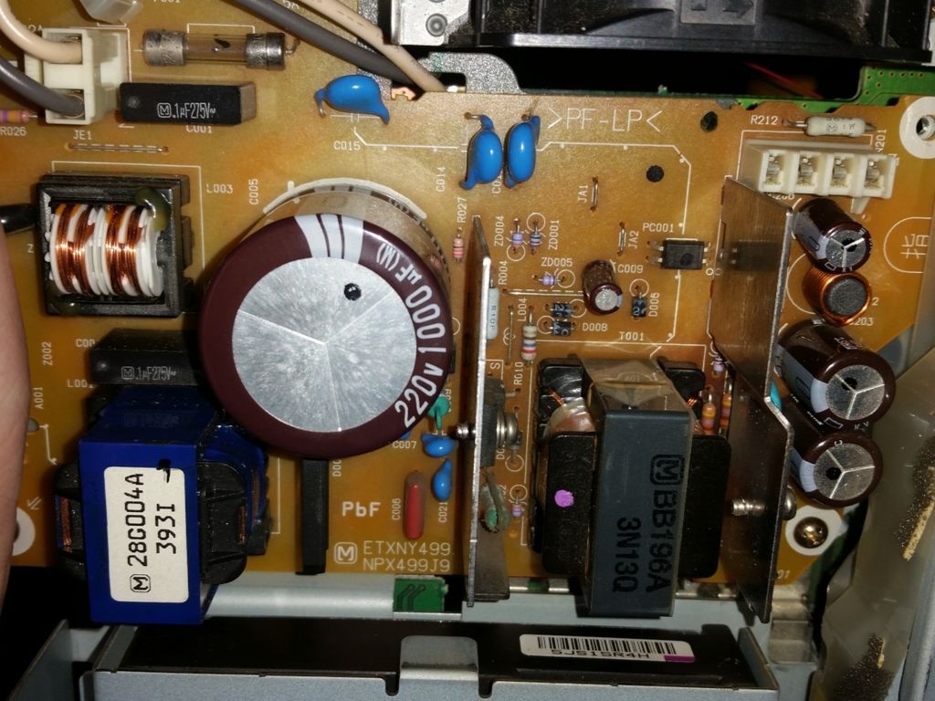

    Sorry for the delay in response. I work 7 days a week so I'm not always at my PC. I found the fuse that went but, but it's unmarked. Is there a schematic out there for this thing so I know what to replace it with? I can also include a picture with the circled fuse if that would help.

    There's indication for the values of fuses printed on the circuit board soldermask.

    Ok, so after looking on the board for any signs, I still can 't find it. This the only part on the board that isn't getting a reading. Any clue where the value would be printed for this one?

    That part is a capacitor. It's supposed to not give a reading. The fuses are marked as fuses on the board. If you bother reading the stuff that is written on the board copper you will see it.

    Sorry about that then. All the other capacitors were giving off a reading.
