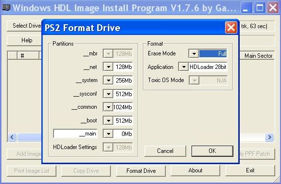

  7. GreatDragon
    GreatDragon PSX DESR-5000 UPDATE DISC 1.20
    Jan 11, 2015
    In Windows

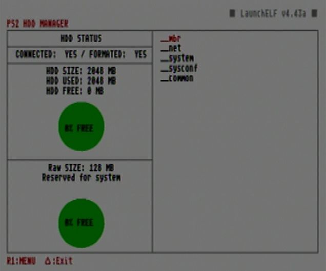

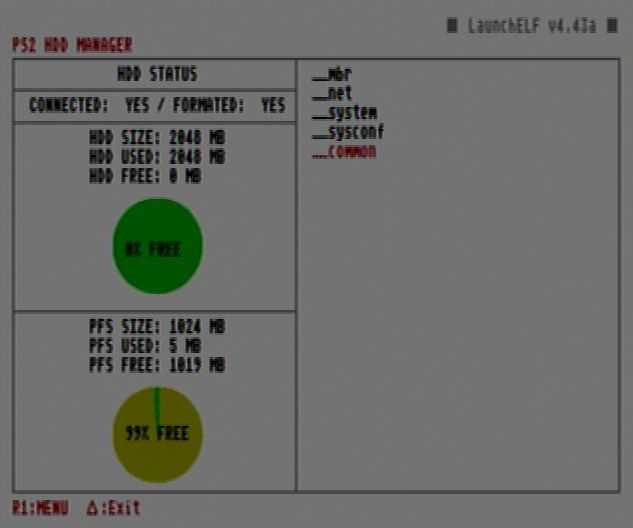

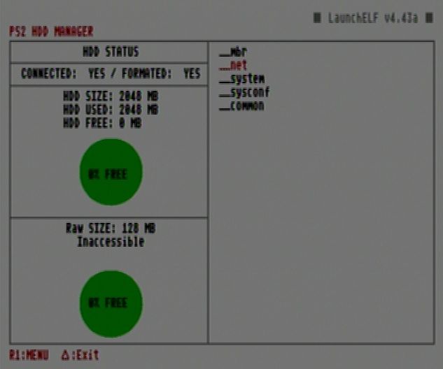

  8. GreatDragon
    Jan 11, 2015
    Genuine HDD (working 5000)
      File size:
      26.8 KB
      Views:
      343

  9. GreatDragon
    Jan 11, 2015
    On Genuine HDD without boot and main
    How correctly to format blank genuine HDD ?
  10. GreatDragon
    Jan 11, 2015

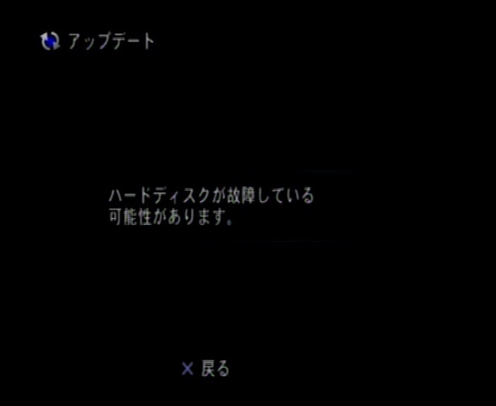

    Genuine DISC through ULE + blank genuine HDD
    Please in English
      File size:
      9.1 KB
      Views:
      300
  11. AKuHAK
    AKuHAK Spirited Member
    Jul 25, 2012
    172
    46
    Please stop posting so many posts - you can use edit button.
    Disk is encrypted - you can see what is in it only in this particular unit - you cannot see it on pc or another dvr or another ps2.
    Can you explain WHY you want to format hdd?
    svotib and krHACKen like this.
  12. GreatDragon
    Jan 11, 2015
    My mistake , HDD was formated in Windows
    I want recovery partions to blank genuine HDD ,
    then checking install Upd Disc
  13. l_oliveira
    l_oliveira Officer at Arms
    Nov 24, 2007
    3,879
    245
    Format the HDD on windows will have no effect. The PSX will see the format as garbage (the encryption is transparent for the PS2 side. it doesn't even know the HDD is encrypted.)
