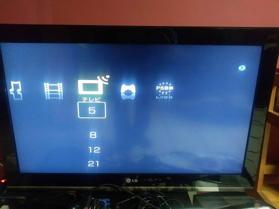

    A friend of mine bought a PSX DVR system (7100) and it freezes up on this screen. Would this be signs of dying HDD or something else?

    I guess this happens after powering on the unit since the TV menu (テレビ) is selected by default upon starting the device. The blue circle in the upper right corner usually keeps blinking for up to 20 seconds during which the XMB cannot be used and the remote control is unresponsive.
    Judging from the screenshot, channel 5 is pre-selected and therefore you should either see TV static or the actual TV programme (in case the device is connected to UHF/VHF or BS) after a successfully starting the device.
    If that is not the case and that blue circle also froze, my assumption is a faulty boot procedure. The more tech-savvy can probably elaborate on the boot procedure details to narrow down failing components.
    Edit: According to the manual (p. 130) you can also try the following troubleshooting advice:
    - turn off the device (i.e. stand-by mode, red LED)
    - press and hold the power button for 10 seconds
    - press the power button again to power on the unit

    Sounds like a dying hdd. Be aware that the hdd is paired to the system and can't be replaced.
