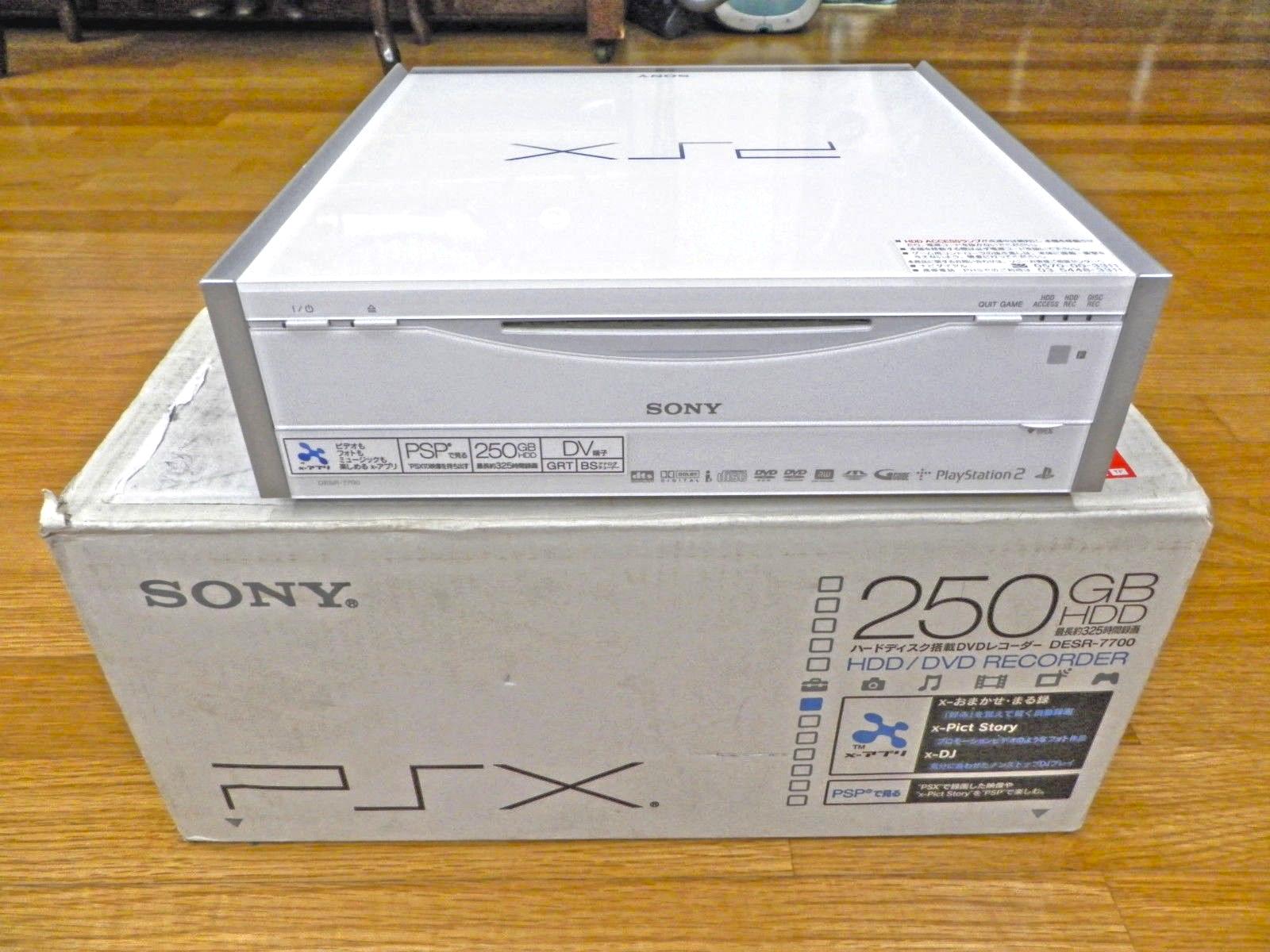

    I bought new PSX DVR (7700) in Japan early 2005 and brought it back home in United Kingdom, it never been power up at once because I don't have the stepdown plug. (Stupid me)
    8 years later I finally decided want to try out my PSX for the very first time but I need some advice from any members here who actually have the experience and knowledgeable of buying the stepdown plug. I have done some the research but it was lacking of any quality information and I don't want to buy any stepdown plug as I want the high quality product that is risk free/prevent from damaging the PSX system and my home socket.
    Back of my PSX box, Power is 100V/80W in Japan.
    so I ask here If anyone have bought the PSX DVR and Stepdown plug in United Kingdom.
    Thank you
