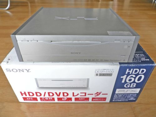

    They sold silver ones, as someone is selling one on eBay.

    there are only 2 colors for the DESR. Most of them are white. the only exception is the DESR-5100S which has silver color.
    All other colors such as red, yellow...etc never got released.
